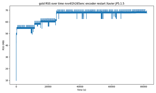

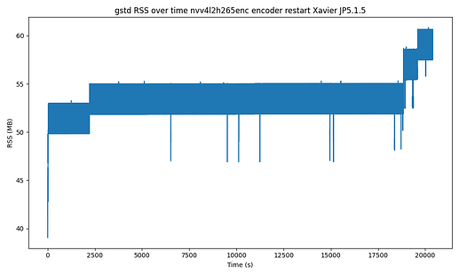

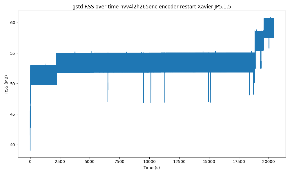

Hi all,
This is related to the same memory leak described in Memory leak in JetPack 5.1.5 when repeating the start/stop cycle of a GStreamer pipeline including nvv4l2h265 encoder using a TX2 and JetPack 4.6.4.
NVIDIA provided a fix for JetPack 5.1.5 and we got the following results
So we would like to fix the leak in JetPack 4.6.4 and produce the same behavior as the image attached above.
Regards!
