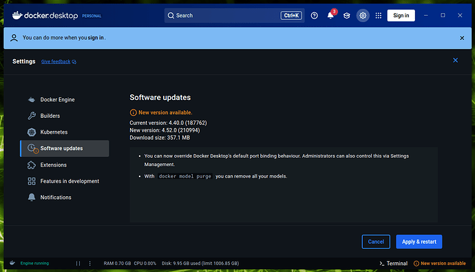

Here is a โ€œPlaybookโ€ tutorial how to install Docker Desktop on ARM64
The Docker Desktop deb for ARM64 Linux is Version 4.40.0 (187762) but the new Version is 4.52.0 (210994) - could not find the link to the ARM64 Linux file for that version yet.
Wrote to the Docker Support with a Request for ARM64/aarch64 Ubuntu Support (NVIDIA DGX/AI Platforms) for Docker Desktop / Model Runner
and here how to install Docker Model Runner
