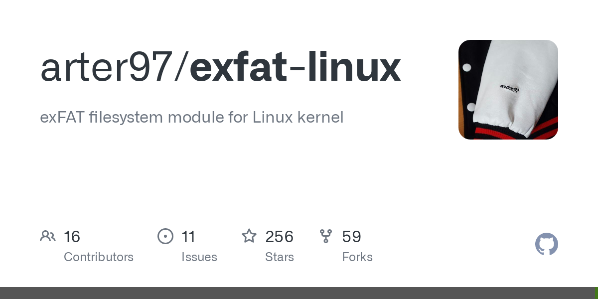

Maybe you should do either of them:
Unfortunately, both of these options don’t work either.
I installed exfat-fuse and exfatprogs.
The linked kernel module doesn’t support kernels above 5.8.
I guess one would have to recompile the kernel to get it working, as it should be working on all kernels above 5.8. And yes it was working on Jetpack 5 previously.
