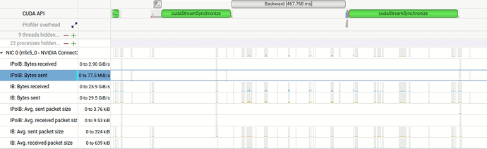

Regarding the results I am not sure but I have these two concerns:
1- GPU metrics are not displayed after a few seconds:
2- Is there anyway to enhance NIC metrics? Are they being captured even?
Best
One thing to keep in mind is that NIC metrics, like GPU metrics, are system-wide and will include activity that is unrelated to your application.
It appears that there is some IB traffic going on, but if you aren’t seeing communication where you expect it - then it could be that your application is using a different network interface (e.g. Ethernet). You may want to engage your friendly local sysadmin to help you confirm that your job is utilizing the appropriate communication channel.
Now - with respect to the GPU metrics - that is a new one for me. I’m not sure what to suggest specifically, but here are some general steps we can follow:
  1. Start single-node: if you don’t run in parallel, how do things look? This can help rule out anything where in some way the multiple profilers are conflicting with one another.
  2. Shorter session, and less features. Lets confirm that collecting a smaller amount of data goes smoothly. Try something like -s none -t cuda,nvtx --gpu-metrics-device=all --gpu-metrics-frequency=100
  3. Make sure you are using an up-to-date version of the cuda driver and nsys.
