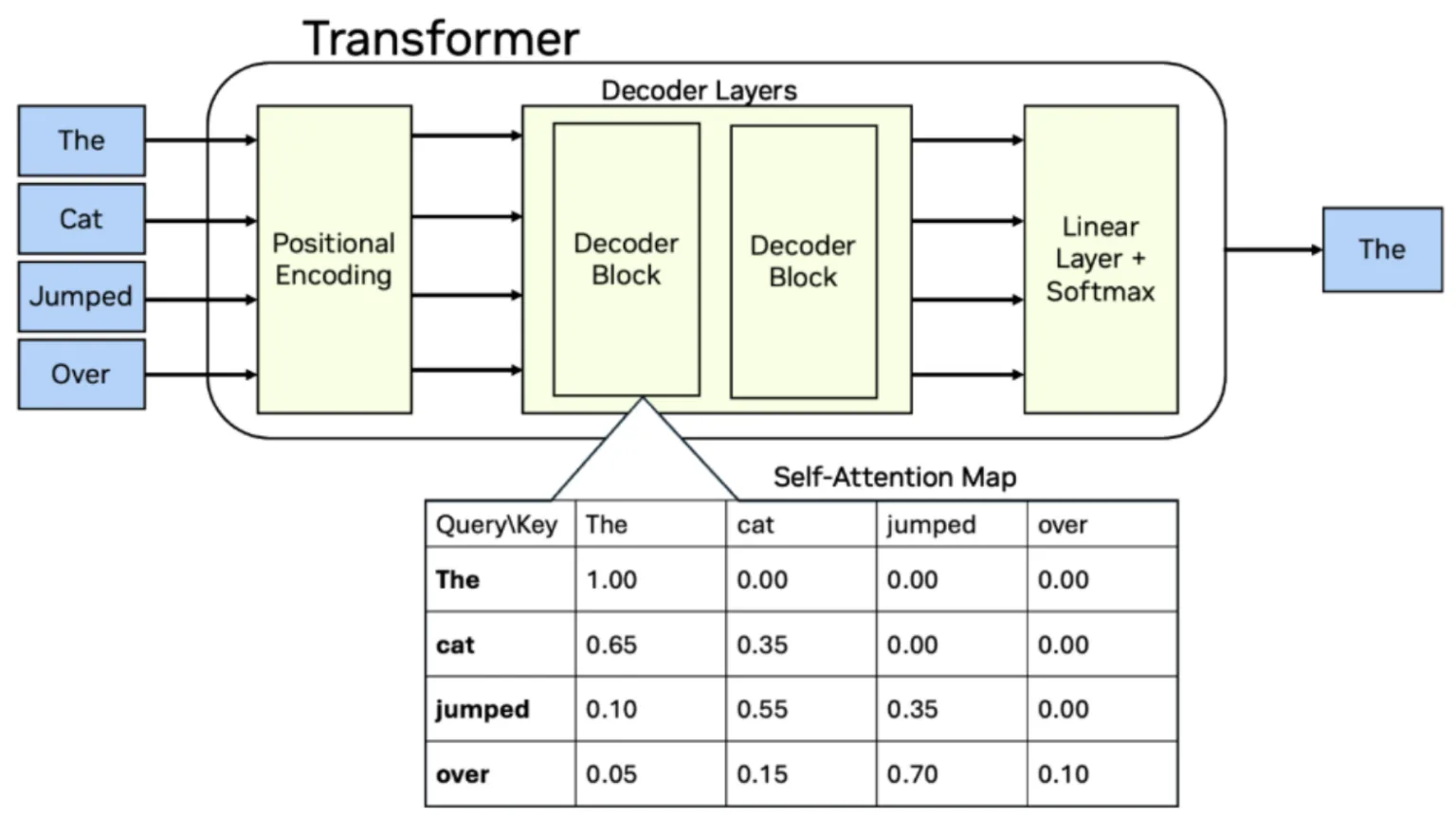

There are 48 layers in the model, every 4th layer using GQA attention while the remaining use the new linear attention. Large language models (LLMs) use attention layers to interpret and assign importance to each token of the input sequence. Less mature software stacks lack pre-optimized primitives for novel architectures or the specific fusions required to make the constant switching between attention types efficient.
Figure 1. A general representation of how an input sequence is parsed and weighted by a transformer
