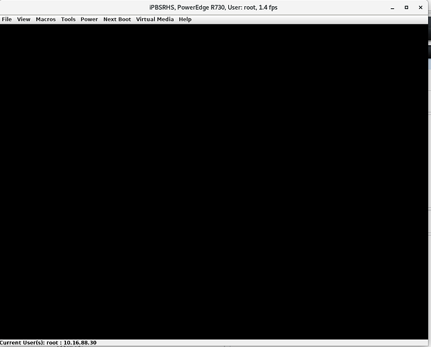

Now I think the local display on :0 is gone. I can’t see anything, it’s blank.
Please switch to vt7: ctrl+alt+f7
I see a cursor blinking but still dark screen. Thanks!
Please check the other consoles: ctrl+alt+{f1…f12}

I’ve checked your logs, looks like RHEL is using vt1: ctrl+alt+f1
I do get the display on ctrl+alt+f1 but I don’t see the login screen. Here is the output of ps aux|grep X

The xserver on the matrox seems to be crashing.
Please create a new nvidia-bug-report.log
here it is… Thanks a lot.
nvidia-bug-report.log.gz (1.64 MB)
The xservers are probably fighting over the vt, please change the systemctl unit:

Once you start gdm it should auto-switch to the correct vt. According to the logs, rhel uses vt1.
The local graphic display now works and users can render hardware graphics over XRDP using xorg fine. The users cannot use their applications over XVNC but they are fine using it over XORG and they have to use vglrun to launch their application. I got their confirmation and they are happy it’s working. I noticed one thing after adding the new card. When I SSH from another Redhat server over terminal to this server with new graphics card, I don’t see the prompt to enter password. It just blinks and stays there. I’m able to SSH over putty from my Windows desktop but Redhat said not to use putty so I use another Redhat system to check tasks on this server. IS the new graphics card causing this issue?
