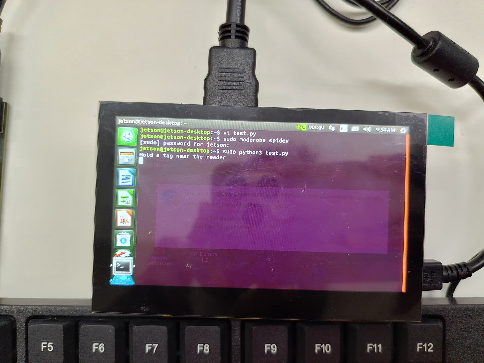

Not Getting any output after running Jetson-MFRC522 python code
Currently i am referring this web for reading the Card reader and for all requirements and Sample python code:-
but runnig this python code RFID card is not giving any output
i have checked Voltage input also it is 3.3v only .
also used logic analayzer but no signal is going .
Can somebody help me in this situation why it is not reading the RFID card ?

I am using devkit for Jetson Nano Developer kit .
how to verify SPI loopback test working or not ?
for jetpack version i have attached one image can you tell which jetpack it is ?
