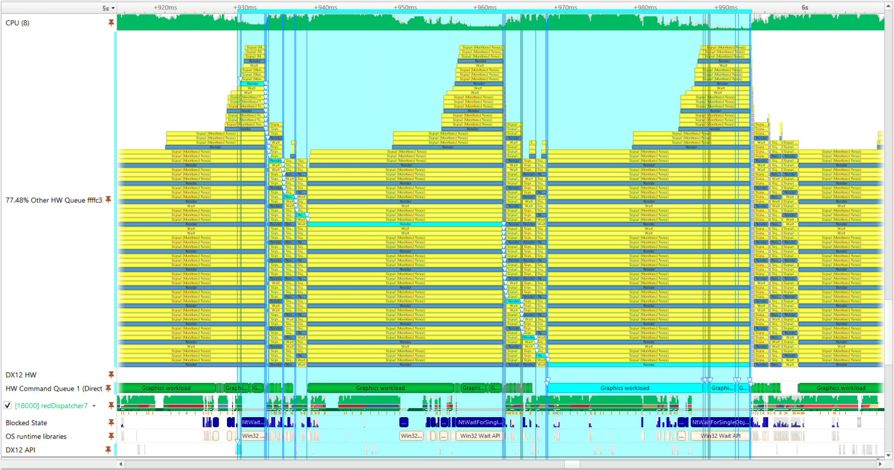

Figure 1. Windows interrupt trace lets users see when the kernel is operating within your CPU thread.
This release also added data capture that will help users understand when, where, and how deep packets are queued.
Figure 2. Improved graphics correlation allows users to explicitly follow API work submissions through WDDM queue packets and to their GPU workloads, rather than inferring it via timing.
