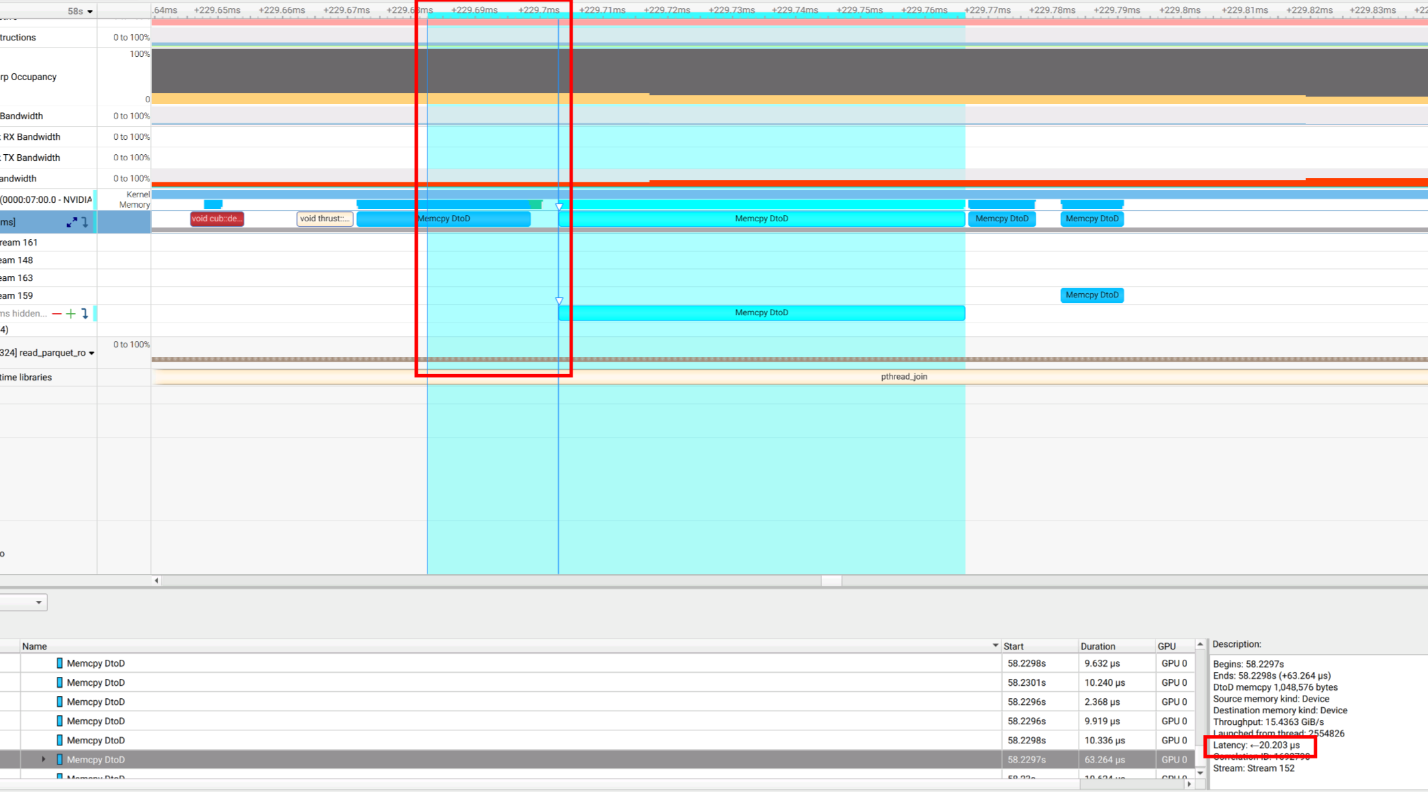

Hi Nsight Systems experts,
I frequently use the Nsight Systems GUI, and in the “Events View” I can see a “Latency” value for each kernel and memory operation (which I’ll refer to as functions). I interpret latency here as the time between when a function is scheduled and when it actually begins execution—so it’s distinct from the function’s “duration”.
I find this latency metric very useful and would love to generate a histogram or identify high-latency outliers for optimization. However, I’ve noticed that the GUI table doesn’t allow me to display or sort by “Latency” the way it does for “Duration.”
I’m aware of the nsys CLI and the SQLite files. I did a quick check and found the cuda_kern_exec_trace file (/opt/nsight-systems-20250101/host-linux-x64/reports/cuda_kern_exec_trace.py), which includes a “Queue Dur (ns)” field. I’d like to confirm:
  • Is “Queue Dur (ns)” equivalent to the “Latency” shown in the GUI?
  • Is there a way to display and sort by “Latency” directly in the GUI table?
Thanks in advance for your help!
