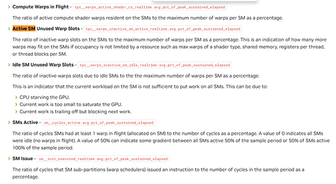

Quick question about nsys GPU metrics for SM Warp Occupancy.
I’ve noticed that “compute warps in flight” and “unallocated warps in Active SMs” don’t always sum to 100%. Why does this occur? Does it indicate the GPU is waiting for data (e.g., memory latency) during computation?
An example:
If you look through the info in User Guide — nsight-systems 2025.3 documentation (direct link to the GPU metrics section of the docs, ignore the link text) you’ll see some suggestions of things that could cause this.
The documentation is complete. The tooltip does not show Idle SM Unused Warp Slots which account for the remaining value to reach 100%.

All of the metrics that you collect are available directly in the nsys GUI panel.
@hwilper
Apologies if I am too pedantic, but I’m hoping to clarify.
Is it possible to enable the GPU metric “Idle SM Unused Warp Slots” in the GUI? Because it is not shown as we see, so it is a contradiction(?)
