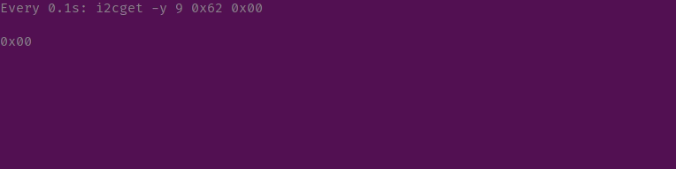

Hi @JerryChang,
I tried resolving this for a bit by checking if my user is in the access group to open video devices:
ls -l /dev/video0
crw-rw----+ 1 root video 81, 0 Dec  5 10:02 /dev/video0
, which seems to be group with the name video, but my user seems to be a member of video:
groups
tas adm cdrom sudo audio dip video plugdev render i2c lpadmin gdm sambashare weston-launch gpio jtop
But even after running the command with sudo, I still get the permission error:
sudo v4l2-ctl -d /dev/video0 --set-fmt-video=width=2472,height=2064,pixelformat=RG12 --set-ctrl bypass_mode=0 --stream-mmap --stream-count=100

So there is a device at address 0x62, but I am unsure how to check if its actually the serializer I expect.
I read about certain registers like 0x00 returning a ID that I can use to confirm its a serializer of type MAX9295A/B as specified in the datasheet of the camera.
But for this device on register 0x00 the return values changes over time:
i2cget_returns
Do you have an idea what this device is and how I can check which of the addresses actually correspond to the serializer and image sensor on the I²C bus?

Yes, it looks like serializer device is not found at the time the driver is loading. That’s the first thing to check otherwise serializer configuration will not be applied correctly and will affect the whole chain.
It seems that you are finding the 0x62 address at bus 9, but the values from register 0x00 are changing during the time. Could you try using i2ctransfer instead and reading 0x0D register? This one will show the DEV_ID. You could confirm the value in the datasheet.
i2ctransfer -y -f 9 w2@0x62 0x00 0x0d r1
If this matches the serializer expected value, you could try inspecting the “max929x_detect_serializer” and adding logging to see why is this part failing. You could also try a adding a delay to see if the serializer needs some time to appear on the bus.
