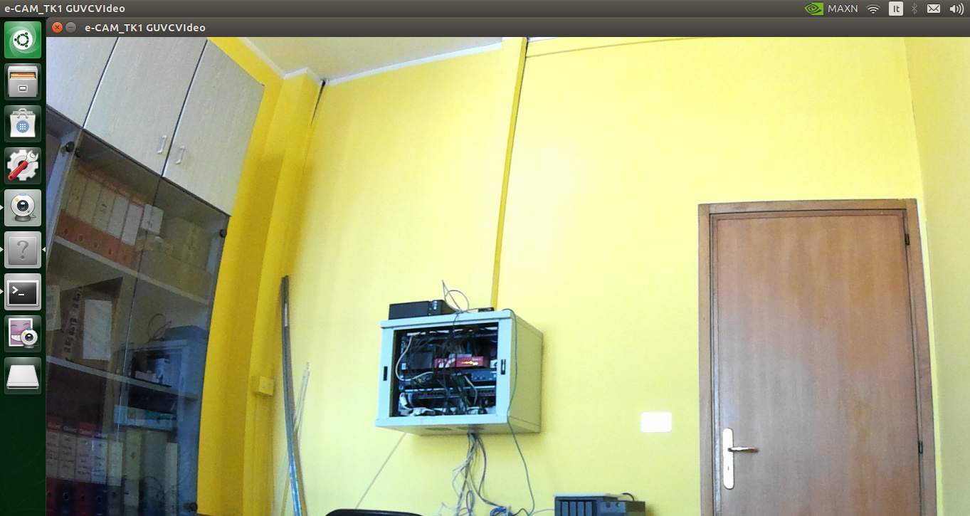

i have install ar0512 camera. It looking good on display.
However, nvarguscamerasrc show me

You mention ‘It looking good on display’. Please share the command for reference. Argus is for Bayer sensors using hardware ISP engine. Probably yours is not this case.
I display the camera with standard ubuntu Cheese or GTK+ UVC Viewer
I don’t have a working pipeline at the moment
It looks like you should use v4l2src to launch it. Please take a look at
Jetson Nano FAQ
Q: I have a USB camera. How can I launch it on Jetson Nano?
solved
gst-launch-1.0 v4l2src device=/dev/video0 ! "video/x-raw, format=(string)UYVY, width=(int)2592, height=(int)1944" ! nvvidconv ! "video/x-raw(memory:NVMM), format=(string)I420, width=(int)1920,height=(int)1080" ! nvoverlaysink overlay-w=1920 overlay-h=1080 sync=false
