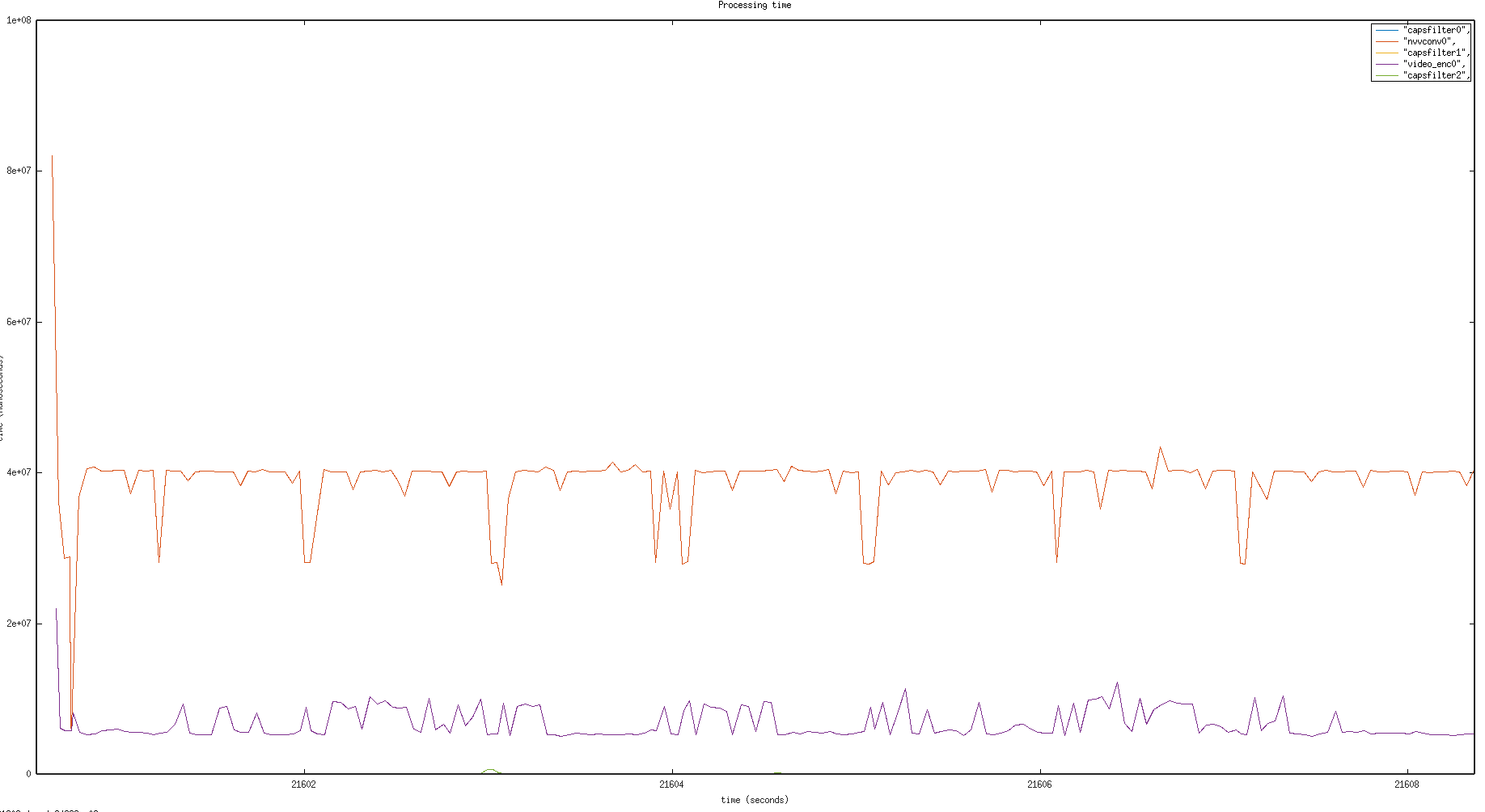

I’m running a gstreamer pipeline on a Jetson AGX Xavier devkit.
The Jetson is connected to a camera with v4l2src interface. My problem is that most of the latency in the pipeline comes from nvvidconv which is unexpected. The pipeline is the following:
GST_DEBUG="GST_TRACER:7" GST_TRACERS="proctime"  gst-launch-1.0 rtpbin name=rtpbin v4l2src num-buffers=200 name=src_video0   device=/dev/video0 ! vid
eo/x-raw,format=YUY2,width=1920,height=1080,framerate=60/1 ! nvvidconv ! video/x-raw\(memory:NVMM\), format=\(string\)I420 ! nvv4l2h265enc bitrate=4000000 insert-sps-pps=1 maxperf-enable=true name=video_enc0 ! video/x-h265, stream-format=\(string\)byte-stream ! rtph265pay name=rtp_payloader0 ! application/x-rtp,media=\(string\)video,clock-rate=\(int\)90000,payload=\(int\)96,ssrc=\(uint\)11234,encoding-name=\(string\)H265 ! rtpbin.send_rtp_sink_0 rtpbin.send_rtp_src_0 ! udpsink   port=5000  host=127.0.0.1 rtpbin.send_rtcp_src_0 ! udpsink   port=5001  host=127.0.0.1  sync=false async=false udpsrc port=5003 ! rtpbin.recv_rtcp_sink_0
I’m measuring the processing time of each element with GstShark and get the following plot:
As you can see the encoder takes around 10 ms and nvvidconv takes 40 ms which is unexpected.
I tried a couple things, but they didn’t help:
  1. GStreamer pipeline is slow Set nvpmodel -m 2 and run jetson_clocks, set io-mode=2 for v4l2src
  2. Nvcamerasrc, tee, and nvvidconv slow - #5 by DaneLLL Lock nvenc clock and set rate to max_rate.

We can see that the NVENC clock is set to ~1 GHz.
Please advise what else might cause nvvidconv to be slow. Thank you!

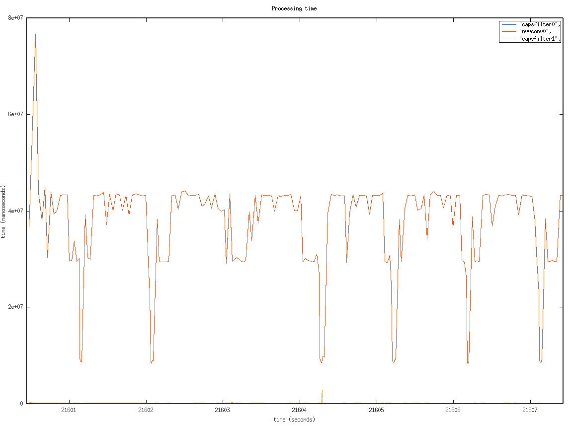

Update: Even the following simpler pipeline produces ~40 ms latency for nvvidconv
GST_DEBUG="GST_TRACER:7" GST_TRACERS="proctime"  gst-launch-1.0 v4l2src num-buffers=200 name=src_video0   device=/dev/video0 ! video/x-raw,format=YUY2,width=1920,height=1080,framerate=60/1 ! nvvidconv ! video/x-raw\(memory:NVMM\),format=YUY2 ! fakesink

I tried that, now it is doing around ~40 fps.
If I run the following command, I get 60 fps:
gst-launch-1.0 v4l2src device=/dev/video0 ! video/x-raw,format=UYVY,width=1920,height=1080 ! fpsdisplaysink video-sink=fakesink text-overlay=false -v
If I run the following command, I get 40 fps:
gst-launch-1.0 v4l2src device=/dev/video0 ! video/x-raw,format=UYVY,width=1920,height=1080 ! nvvidconv ! 'video/x-raw(memory:NVMM),format=NV12' ! fpsdisplaysink video-sink=fakesink text-overlay=false -v
This also yields 40 fps (keeping the color format UYVY instead of converting to NV12):
gst-launch-1.0 v4l2src device=/dev/video0 ! video/x-raw,format=UYVY,width=1920,height=1080 ! nvvidconv ! 'video/x-raw(memory:NVMM),format=UYVY' ! fpsdisplaysink video-sink=fakesink text-overlay=false -v
Is there anything else I could try to make this run at 60 fps?
I also tried checking a pipeline with videotestsrc, and that has no problem producing 60 fps:
gst-launch-1.0 videotestsrc ! video/x-raw,format=UYVY,width=1920,height=1080,framerate=60/1 ! nvvidconv ! 'video/x-raw(memory:NVMM),format=NV12' ! fpsdisplaysink video-sink=fakesink text-overlay=false -v
Please set sync=0 to fakesink and check again:
... ! fpsdisplaysink text-overlay=false video-sink=fakesink sync=0
FYI: The solution to the above problem was using nvv4l2camerasrc instead of v4l2src. After this change, the pipeline can run at 60 fps no problem.
