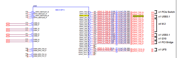

USB issue always requires the schematic.
Hi Wayne,

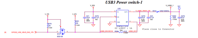

Below is the screenshot of the schematic.
We have verified TP7(USB3 Power-switch 1) point. It is observed to be 5V.
We tried on one more AGX xavier 32GB module we are observing the similar issue as AGX xavier Industrial module. Below I have attached the dmesg_log and dts of all 3 modules.

It looks like you didn’t give vbus-supply node and a regulator to meet your design.
Hi Wayne,
Can I know where this need to be updated.
