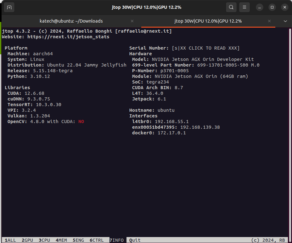

Hello. actually. I saw the a lot of pytorch and jetpack issues, and even I saw very recent issue.
this issue is very similar to me.
I installed pytorch through devpi and legacy wheel in GitHub - davidl-nv/torch, but I feel both are not quite different. these eventually encoutered same error.
also, I installed nccl but it is not help my problem.
first of all below cmd doing well but occure β€œimport torch” error
pip install --no-cache-dir torch-2.8.0-cp310-cp310-linux_aarch64.whl
(test_nccl) katech@ubuntu:~/Downloads$ pip install --no-cache-dir torch-2.8.0-cp310-cp310-linux_aarch64.whl

(test_nccl) katech@ubuntu:~/Downloads$ python
Python 3.10.12 (main, Aug 15 2025, 14:32:43) [GCC 11.4.0] on linux
Type "help", "copyright", "credits" or "license" for more information.
>>> import torch
  File "<stdin>", line 1, in <module>
  File "/home/katech/Downloads/test_nccl/lib/python3.10/site-packages/torch/__init__.py", line 407, in <module>
    from torch._C import *  # noqa: F403
ImportError: libcusparseLt.so.0: cannot open shared object file: No such file or directory

(test_nccl) katech@ubuntu:~/Downloads$ pythoon
bash: pythoon: command not found
>>> import torch
>>> exit()
but if install torchvision –force, it can make work import torch
>>> import torch
>>> print(torch.cuda.nccl.version())
  File "/home/katech/Downloads/test_nccl/lib/python3.10/site-packages/torch/cuda/nccl.py", line 46, in version
    ver = torch._C._nccl_version()
AttributeError: module 'torch._C' has no attribute '_nccl_version'
>>> torch.__version__
'2.8.0+cpu'
>>> exit()
well anyway I can import pytorch but cannot using gpu.
I tested all of your pytorch wheel, both github legacy and pypi. but these work same.
why this error occured?
jtop and is below, Orin AGX.
can you try upgrading to jp 6.2? also pls install cusparseLt first and then install pytorch first. only after clearing pytorch issue u need to move with torchvision.
I tried at jetpack 6.2 all the solution before. I gave up so changed to 6.1.
for me it worked on jp 6.2.1. anyways i’ve seen that u were able to solve the issue in my previous topic. so maybe u can close the topic. :)
Based on your error, there are two different issues in your environment.
Please install cuSPARSELt from the link below
The second error happens when you try to force install the torchvision.
It will reinstall the torch from upstream, which is not expected.
So please install the cuSPARSELt package and try to re-install the PyTorch packages from GitHub - davidl-nv/torch again.
