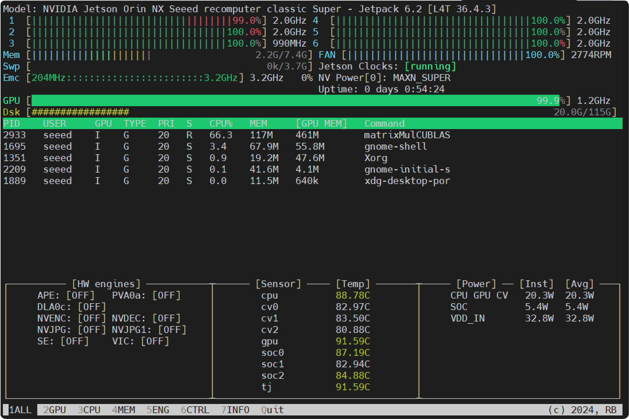

Hi nvidia team,
I am working with a Jetson Orin NX 16G in super mode(JP6.2) on my custom carrier board.
When I test the max power by following this( Jetson/L4T/TRT Customized Example - eLinux.org).
I can get the max power of 38W when the device is in the normal temperature(about 25 Celsius).
But when I put the device into high temperature (about 60 Celsius). The max power of the system goes down to
about 33W after about 5minutes.
Here is the screenshot of it:
My problem is that I want to know if there is any doc which can show me the relationship between MAX power and the CPU or GPU temperature?
I would be appreciate that if someone can help me with this.
check this, if it helps:
It seems your thermal cooling solution is not sufficient to support operation at higher ambient temperatures. You will need to improve this to sustain operation at higher temperatures.
