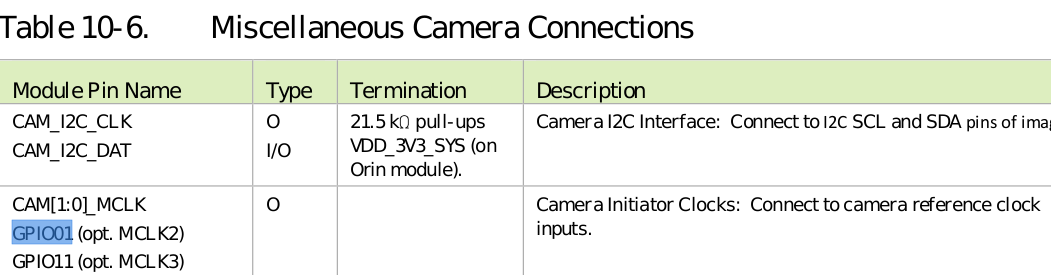

Orin nx imx219 cam1 not work,how to set mclk source
orin nx platform, using custom carrier boart.
when i connect imx219 in csi0, in system i can found a video0 node, but when i connect imx219 in csi2, i can’t found anything.
according to schematic, i had edit tegra234-p3768-camera-rbpcv2-imx219.dtsi rbpcv2_imx219_c@10 node like this:

Didn’t you measure the mclk to confirm.
i had measured, and this pin always output high level.
