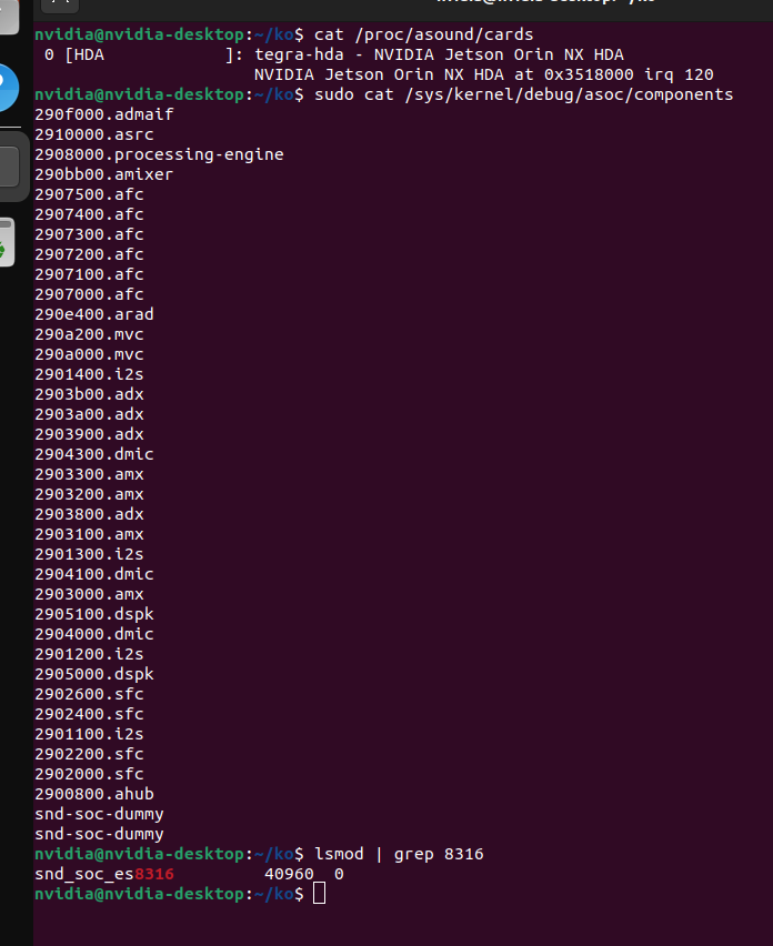

Can you provide the dump of below commands.
  1. cat /proc/asound/cards
  2. dmesg | grep “ASoC”
  3. cat /sys/kernel/debug/asoc/components
The content after I executed the command is shown in the figure below.
This clearly shows the Codec driver has not been probed. Due to it, APE sound card not registered. Can you cross check on whether es8316 driver getting built and probed during boot.

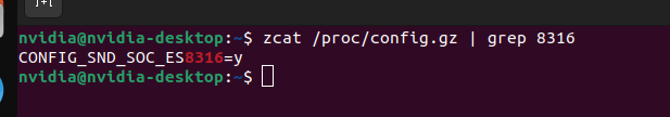

Yes, but when I enter the command “zcat /proc/config.gz | grep 8316”,I get:
When I set “CONFIG_SND_SOC_ES8316=m” in the file “arch/arm64/configs/defconfig, and insmod snd-soc-es8316.ko, I didn’t see any dmesg log information.
I’m not quite sure why the driver for ex8316 cannot be probed into the system.
I believe the codec probe is not happening, this is confirmed from components dump. Can you attach the DT changes done for the codec support
