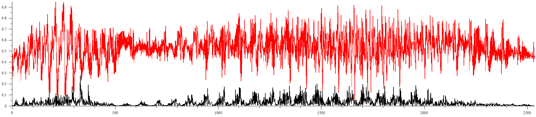

When I compared output of network right after exp/sigmoid (so the values will be in [0, 1] interval) — I got similar shape of plot of results.
Similar but noticable different: for example difference between sigmoid(x) values can be up to 0.25 (for values in [0, 1] interval!).
Plots of sigmoid(x_output) as example:
• C++ (red) and Python (blue):
• red = average between C++ and Python; black = abs(difference):
When in comes to boxes probabilities — there are only ~3-10 values above 0.03 and they often have different indicies.
