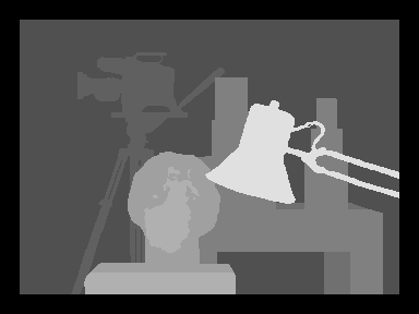

The ground truth of the tsukuba sample stereo pair is:
The result from the nvmedia_imageofst has correct segmentations but the disparity values (relative grayscale) is not correct:

Previously I was using pyplot to draw the gray scale disparity images, it was not correct because pyplot seems to normalize the values by itself. Now I have the results saved by the raw disparity numbers as images. Here’s the results:
The ground truth:
External Media
The opencv result:
External Media
The xavier drive result by
  1. negate the values
  2. shift each value by 5 bits to get the top 11 bits of the value
  3. resize the result to the size of the original image :
External Media
As you can see the values are apparently not on the correct scale.

ground truth, it’s available on the middlebury stereo dataset website:
http://vision.middlebury.edu/stereo/eval/newEval/tsukuba/groundtruth.html
