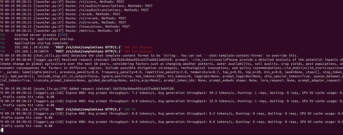

Monitoring vLLM service results:
  1. Jetson Thor: ~53.0 tokens/s
  2. Orin AGX 64GB: ~41.5 tokens/s
Question:
The Thor has 2000 TOPS FP4, while the Orin AGX 64GB has 275 TOPS INT8. Why is the performance difference so small? Could there be something wrong in my setup or testing method?

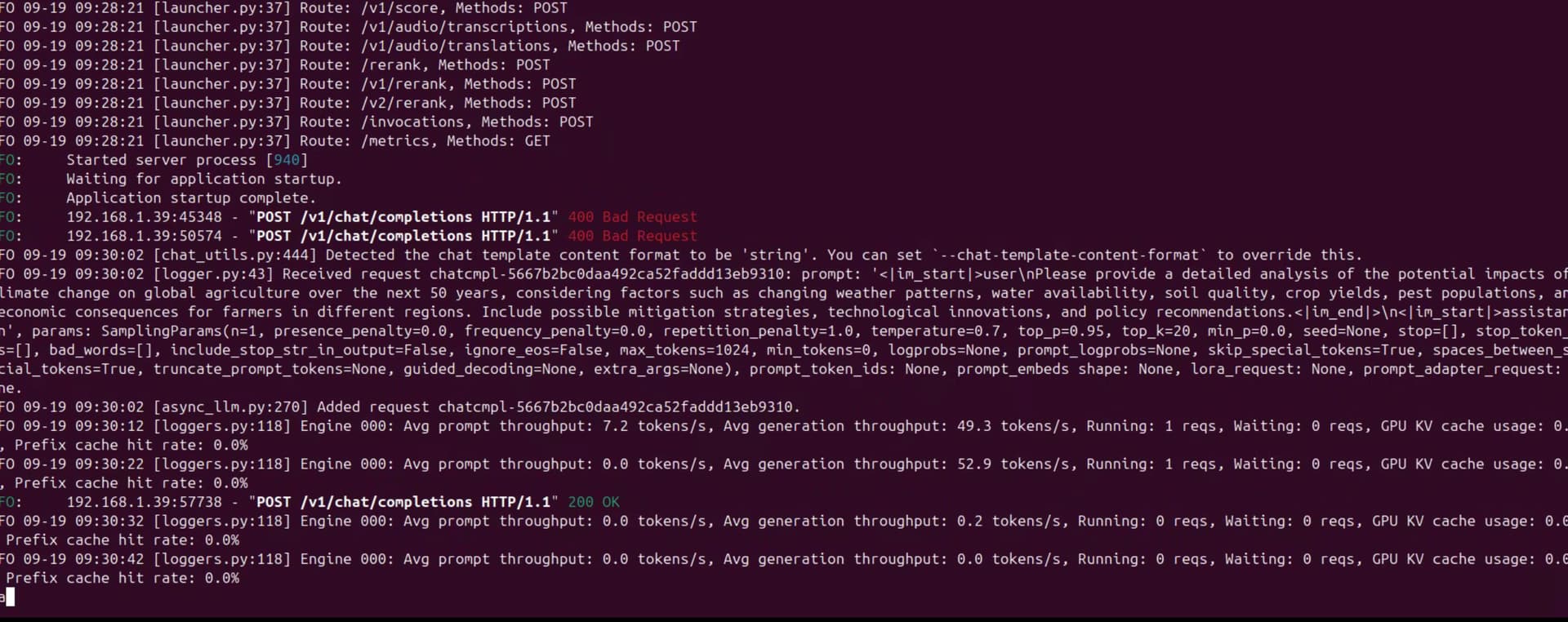

Then I used another device to make a curl request and monitored the Thor device’s vllm log:
However I got the same result?
It was still around 53 tokens/s?
