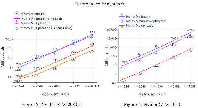

Interesting to see: using the __vmins4() intrinsic vs PTX asm vmin4.s32.s32.s32.add barely makes a difference when the matrix size is coming closer to 4096 on a RTX 2080Ti, the performance difference grows for larger and smaller matrices.
In graph: intrinsic is called ‘Matrix Minimum (optimized)’, PTX asm is called ‘Matrix Minimum’
Have you looked at the different variants with the profiler? I would suspect your observations to boil down to varying efficiency in accessing memory, which dilutes effects from efficiency using the computational cores. In other words, slight shifts in balance between the task being compute bound vs being memory bound.
But the task is never memory bound? Because DP4A is always magnitudes faster, using the same access pattern.
DP4A in the graph is ‘Matrix Multiplication’ (orange/red line)
I probably expressed myself poorly by using “bound”. Let me try again: “A shift in the percentage of time that goes towards memory access versus the percentage of time that goes towards computation”. Instead of speculating what the root cause could be, it seems highly advisable to first run a few variants in the profiler, then discuss any salient differences that are observed (if necessary).
Thanks for your help! It is currently too out-of-scope for me to analyse the root cause, but the answer must lie in specific assembly instructions used in PTX vmin4.s32.s32.s32.add which are not used in __vmins4() and its effect on the scheduler (because the input data + memory access patterns are equal) and maybe combined with the fact that the content of the input matrices are predictable (the numbers are a consistently repeating sequence of length 4)…
Or maybe the ability to cache these lines (see my post earlier for full code):
    /*0170*/                   MOV R2, c[0x0][0x140] ;                /* 0x4c98078005070002 */
    /*0178*/                   MOV R3, c[0x0][0x144] ;                /* 0x4c98078005170003 */
Yes that works and improved performance by another factor 2 on an RTX2080Ti. Don’t have the results for GTX1060 but I think it is safe to assume it holds for GTX1060 aswell.
