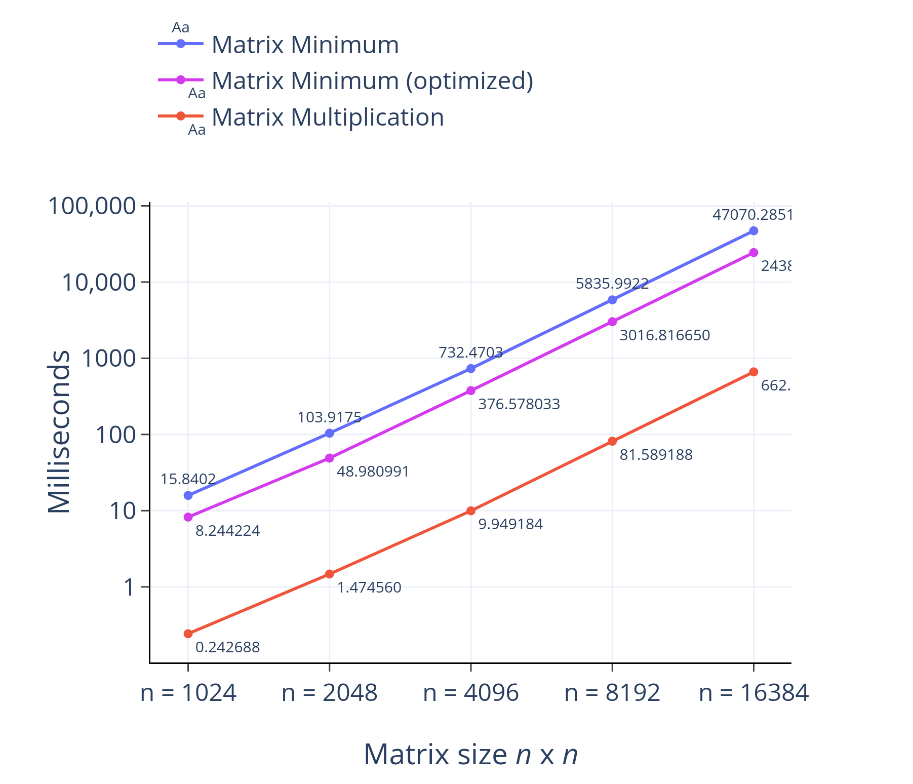

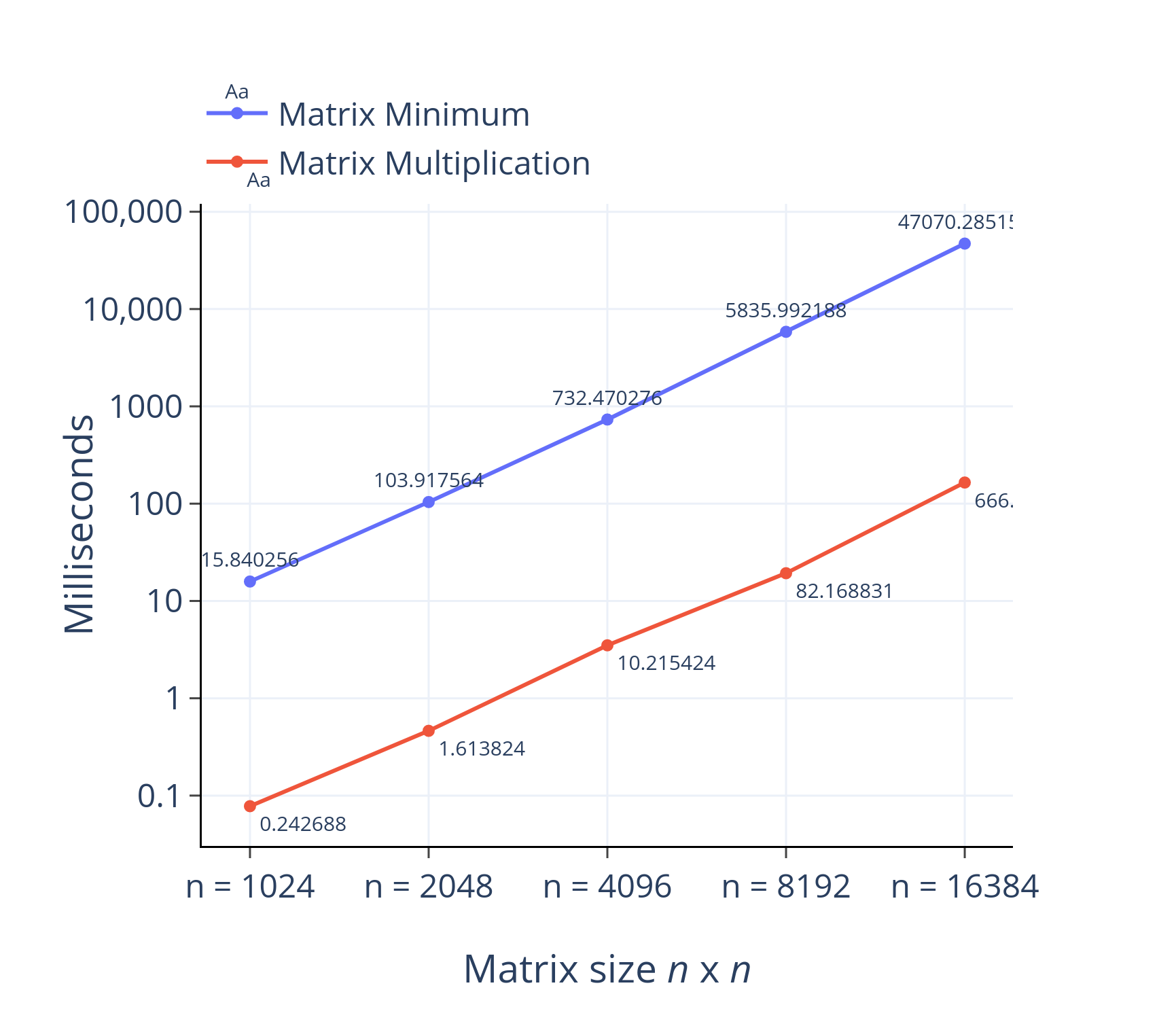

Hi everyone,
I benchmarked the DP4A operation and VMIN4 operation on int8_t datatype (int32_t accumulate) using the CUTLASS library, so trying to fully take advantage of tiled structures. The DP4A and VMIN4 instructions both operate on 2 vectors each containing 4 8-bit signed integers.
Code (VMIN4): cutlass/basic_gemm.cu at matmin · TheNewSound/cutlass · GitHub
Code (DP4A): cutlass/basic_gemm.cu at original · TheNewSound/cutlass · GitHub
I would assume VMIN4 to be faster than DP4A since min() is an easier operation to perform on 2 integers than a multiplication?
But these are my results:
Ran on a GTX1060 3GB
What could be causing this difference? Why is DP4A (matrix multiplication) faster than VMIN4?

Back with news! I updated my VMIN4 code with vmins4 intrinsic and ran the benchmark again, and I got a 2 times performance improvement for every matrix size on GTX1060!! nice!!!
See the lines of code here:
This does however mean that vmin4.s32.s32.s32.add PTX code is not compiled to device code efficiently. See here the difference with using intrinsics:
