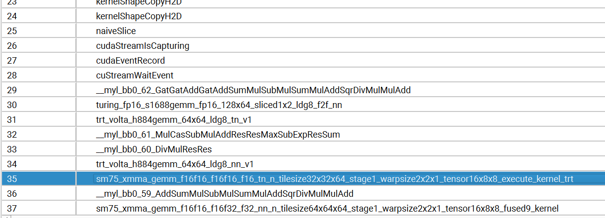

We are using TensorRT via Triton to inference a BERT classification model.
Our model is simply a BERT base + classifier.
Previous we are using TRT 8.5.2, at tail of trtexec, the log shows
Average on 10 runs - GPU latency: 1.52078 ms - Host latency: 1.53953 ms (enqueue 1.5259 ms)
But after we upgrade to TRT 8.6.1, at tail of trtexec, the log shows
Average on 10 runs - GPU latency: 4.13606 ms - Host latency: 4.15786 ms (enqueue 0.541821 ms)
It shows alomost 3x latency regression, the source onnx model are same.
it seems the --fp16 didn’t work, I use nsys profile and see the 8.6.1 is always using fp32 cuda apis
you can see it’s using fp32 in 8.6.1
but it’s using fp16 in 8.5.2
attached trtexec logs and nsight logs

Hi @AakankshaS could you repro my issue by repro steps above?
Hi @niuzheng168 ,
We could reproduce the issue. Please allow us some time to work on this.
Thank you for reporting it to us.
