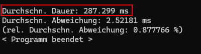

Now, on an RTX A2000 12 GB device I see an overall speedup of execution time by more than 40 % using Ubuntu. Apparently, this is due to correctly working parallelization of data transfers and computation which (seeing the Nsight Systems profiling) doesn’t work on Windows. Here, memory throughput under Ubuntu is slightly slower than on Windows (20.6 GiB/s vs. 22.4 GiB/s as shown by Nsight Systems). This doesn’t have much effect on the overall performance, though.
On a colleague’s RTX 4080, overlapping also works under Ubuntu while it doesn’t on Windows. Still, the overall performance on Ubuntu is significantly slower. This seems to be due to MUCH slower memory transfers: 6.8 GiB/s to 7.5 GiB/s on Ubuntu vs. around 23 GiB/s on Windows.
Now, it is worth noting that the Ubuntu installation used for all tests on all computers is situated on an external hard drive connected via USB. So I gather this may have some impact in one way or another. But how comes there’s almost no difference on the RTX A2000 while memory transfers are that much slower on Ubuntu on the RTX 4080? Meanwhiles, kernel execution times for both systems are more or less the same on Ubuntu or Windows.

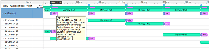

Non-pinned memory copy at the same time as compute measured with the Nsight Systems entry is not isolating memory performance well. Performance can be lower for a whole lot of different reasons. There is a simple bandwidth test tool in the Cuda SDK. Perhaps your colleague can run this?

So, nvbandwidth’s measurings are pretty much what I saw in Nsight Systems. But what does that mean? Why do I get almost 70 % less memory throughput under Ubuntu than under Windows?! Especially seeing that using the very same Ubuntu installation on another machine (different GPU) yields far better results.

When I do a test run in Nsight Systems, however, I don’t see much improvement in memory throughput between variable vs. fixed clocks. Obviously, this may well be because of the limited setup using my laptop. Maybe I can get different observations using my colleague’s desktop computer with the GeForce RTX 4080.

So, we ran a couple more tests on my colleague’s RTX 4080, using variable and fixed GPU and memory rates, on Windows and Ubuntu. Below, I put down the measured average times the tests took with standard deviations as well as the nvidia-smi readings taken while running the tests. We fixed the GPU and memory rates for the respective tests using nvidia-smi --lock-gpu-clocks and nvidia-smi --lock-memory-clocks.
Variable rates, Windows
Mesured durance of tests:
Durchschn. Dauer: 837.917 ms
Durchschn. Abweichung: 40.322 ms
(rel. Durchschn. Abweichung: 4.81218 %)

What we see is this:
On Windows, using fixed rates improves the performance of the test code by about 27 %. Also, standard deviation of the measured durances drops from almost 5 % to 0.5 %. Meanwhiles, Nsight Systems shows there’s still no overlapping of transfers and computation happening here. The improvement in performance seems to be due to slightly better kernel execution times which would be expected if we keep the GPU in a high performance state. Memory transfers for variable and fixed rates are about the same, somewhere between 22.5 GiB/s and 24.5 GiB/s.
On Ubuntu, execution times between variable and fixed rates stay the same. Okay? Kernel execution here, too, as a bit faster with fixed rates. Also, under Ubuntu there is overlapping happening between kernel executions, H2D transfers and D2H transfers. But, memory transfers are happening reeeally slowly, with less than 7 GiB/s.
I strongly feel that the explanation - and possibly solution - for this behaviour on Ubuntu lies in the following bits of information. Note that all tests listed above were run using the same GPU, GeForce RTX 4080. Only the OS (plus drivers, of course) changed:
  • On Windows, nvidia-smistates the device is using PCIe 4x16 while on Ubuntu, the maximum seems to be PCIe 3x16.
  • On Windows, cudaDeviceProp states an asyncEngineCount of 1 which indicates that concurrent kernel execution and memory transfers are possible, but not concurrent H2D and D2H transfers. On Ubuntu, asyncEngineCount is stated to be 2 which would mean that concurrent H2D and D2H transfers are also possible.
  • On Windows, there is no overlapping whatsoever to be seen in Nsight Systems. On Ubuntu, I see maximum overlapping with kernel executions, H2D and D2H transfers all happening at the same time.
Surely, this behaviour must have some explanation in how the OS or the driver utilizes the hardware? I’d assume there should even be a way to configure this? Anyone?
All measurements are on one and the same machine (as in: physically the same machine, not a second “identically configured” machine), correct?
