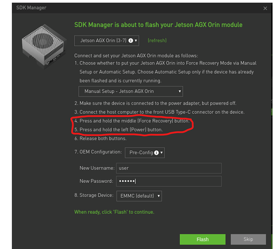

Hi Trumany,
But during first flashing time we need to press power_button and force recovery button simultaneously then how auto power on work without Button MCU circuitry?
Read 4 & 5 points in attached image.

Are you make a custom board without power button, and only auto power on? If so, you need to add a recovery button. When you want to enter recovery mode, you only need to hold recovery button and plug in power cable.
Yes I am making custom board so that whenever my board connected to backpanel it starts booting automatically.
So for first time programing we need recovery button connected directly connected on FORCE_RECOVERY_N Pin to make it short to GND. Is my understanding correct?
Yes.
what is the need of it in my auto power on case?
It can be waived in auto power on design.
