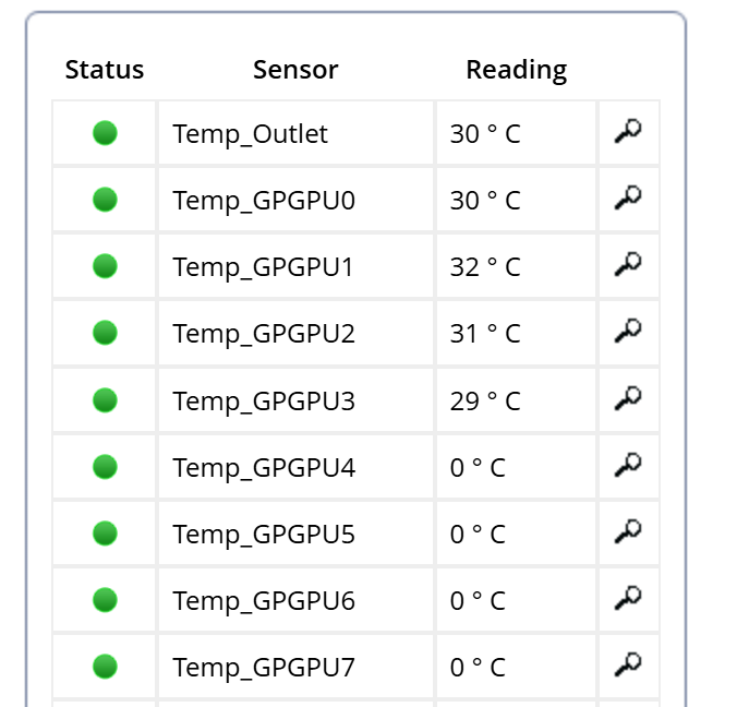

I installed NVIDIA DGX-1 with all 8 GPUs but when tested only 4 GPUs worked. I tried changing the GPU location but the result is still the same. There are only 4 active GPUS slots 0,1,2,3. I tried many ways but none worked. I don’t know why, hope someone can help
Sounds like either the GPU tray or the GPUs are bad. If you move them around and the PCIe bus addresses stay the same for the “working” GPUs, then you’ve got a bad GPU tray. If the bus addresses change, then I’d suspect you have some bad GPUs.

Yes, I don’t have a DGX-1 support contract. I think it got a bad GPU tray. So what should I do, replace a new GPU tray or do something else?
