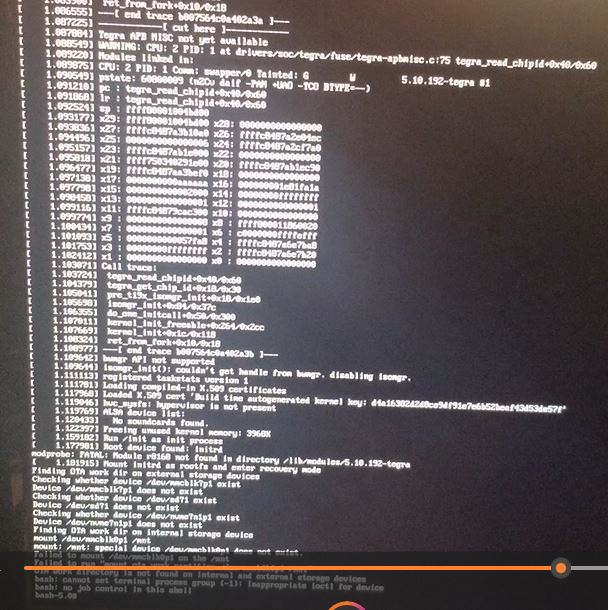

Is the Bash shell similar to bash-5.0#?
Based on your log, it seems to be functioning normally. Have you noticed any errors displayed on the HDMI port?

I have only been able to external screen shot the HDMI output - so see the attached screenshots of pre and after starting shell.
As it only takes 1.7 seconds before initialization of Linux kernel fails.
The only obvious error i see is that it complains about a missing network driver. Tried with or without internet cable attache.
