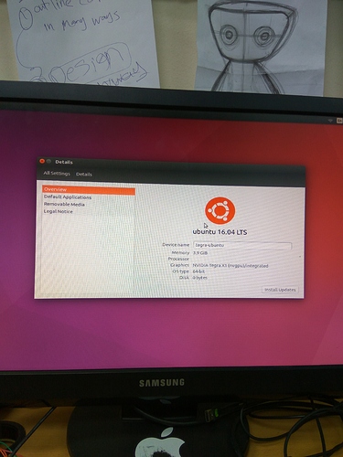

[img][/home/ali/Downloads/IMG_20161001_145844.jpg]
why theirs a missing info about processor ???
1269960 - crash in CanvasRenderingContext2D::EnsureErrorTarget on big endian...
RESOLVED (lsalzman) in Core - Graphics. Last updated 2016-07-26.
Hi AliNada,
Processor field in Ubuntu System Setting → Details was empty because of missing model name in /proc/cpuinfo.
We will add this support in coming release, and user still could move onto other things without this info.
