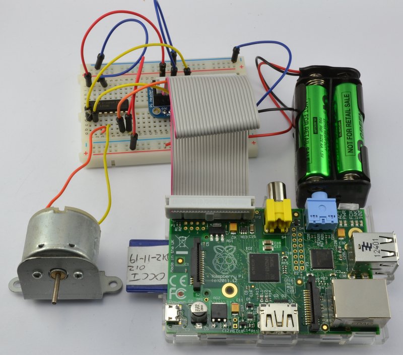

Modern OS, including linux, windows, etc., are not real time OS. For real time process such as PWM servos control, they may have some issues. Depending on the requirements, some non-real-time PWM control, such as LED or FAN control, it is still fine. But for real-time PWM control, the individual real-time control module should take the place.
However, it is still possible to do the job with only Jetson Nano itself. It may need some kernel tweak and testing. A lot of work has been done on Raspberry Pi platform.
Is it still reliable when CPU is on heavy load or multitasking heavily? I dont know.
