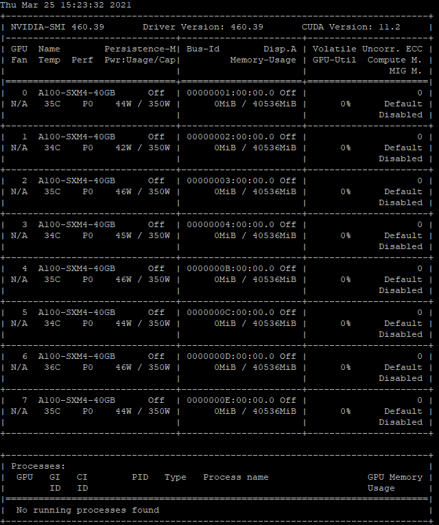

Can you run following command and share the result?
$ nvidia-smi
$ dpkg -l |grep cuda

Thank you for the suggestion. I ran sudo apt-get install nvidia-modprobe but the error still occurs.
Just confirming that the error is exactly the same after installing nvidia-modprobe:

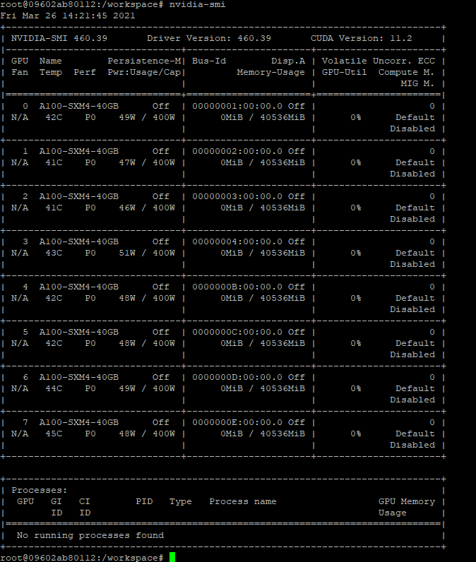

To narrow down, can you login the docker
docker run --runtime=nvidia -it -v <yourfolder> :/workspace/tlt-experiments nvcr.io/nvidia/tlt-streamanalytics:v3.0-dp-py3 /bin/bash
In the docker, please refer to python - How to remove cuInit failed: unknown error in CUDA (PyCuda) - Stack Overflow and run some commands.
For example,
# python
Python 3.6.9 (default, Oct 8 2020, 12:12:24)
[GCC 8.4.0] on linux
Type “help”, “copyright”, “credits” or “license” for more information.
>>>import pycuda
>>> import pycuda.driver as cuda
>>> cuda.init()
# nvcc -V
I’ve followed the advice and still encounter the same error.
Here are the results of running cuda.init(), nvcc -V, and nvidia-smi within the tlt-streamanalytics:v3.0-dp-py3 container:
Next I ran sudo nvidia-modprobe -u before launching the jupyter notebook, but encountered the same error. The same error occurred whether or not I used the --allow-root flag.
To narrow down, could you please download one triton server docker (Release Notes :: NVIDIA Deep Learning Triton Inference Server Documentation) and run previous commands again in it?
BTW, which gpu card are you using?

ii cuda-sanitizer-11-1 11.1.105-1 amd64 CUDA Sanitizer
hi libcudnn8 8.0.4.30-1+cuda11.1 amd64 cuDNN runtime libraries
ii libcudnn8-dev 8.0.4.30-1+cuda11.1 amd64 cuDNN development libraries and headers
hi libnccl-dev 2.7.8-1+cuda11.1 amd64 NVIDIA Collectives Communication Library (NCCL) Development Files
hi libnccl2 2.7.8-1+cuda11.1 amd64 NVIDIA Collectives Communication Library (NCCL) Runtime
ii libnvinfer-dev 7.2.1-1+cuda11.1 amd64 TensorRT development libraries and headers
ii libnvinfer-plugin-dev 7.2.1-1+cuda11.1 amd64 TensorRT plugin libraries
ii libnvinfer-plugin7 7.2.1-1+cuda11.1 amd64 TensorRT plugin libraries
ii libnvinfer7 7.2.1-1+cuda11.1 amd64 TensorRT runtime libraries
ii libnvonnxparsers-dev 7.2.1-1+cuda11.1 amd64 TensorRT ONNX libraries
ii libnvonnxparsers7 7.2.1-1+cuda11.1 amd64 TensorRT ONNX libraries
ii libnvparsers-dev 7.2.1-1+cuda11.1 amd64 TensorRT parsers libraries
ii libnvparsers7 7.2.1-1+cuda11.1 amd64 TensorRT parsers libraries
root@8645c75918be:/workspace# nvcc -V
nvcc: NVIDIA (R) Cuda compiler driver
Copyright (c) 2005-2020 NVIDIA Corporation
Built on Mon_Oct_12_20:09:46_PDT_2020
Cuda compilation tools, release 11.1, V11.1.105
Build cuda_11.1.TC455_06.29190527_0
root@8645c75918be:/workspace# python
Type "help", "copyright", "credits" or "license" for more information.
>>> import pycuda
>>> cuda.init()
>>> cuda.init()
This error is due to the Fabric Manager not being properly set up.
Can you provide more detail about the problem and solution in this instance?
Did you read the document I linked? It covers those things much better than I can.
Fabric Manager is an additional software component that is basically required any time you have HGX A100 - 8 GPU product configurations (basically systems that use A100 and NVSwitch). The system described here with 8 A100 SXM4 GPUs is one of those.
Fabric Manager must be installed separately from the GPU driver. The document explains how to do it.
If you do not install FM properly, but attempt to use CUDA anyway, a specific error code (“system not yet initialized”) will be reported.
