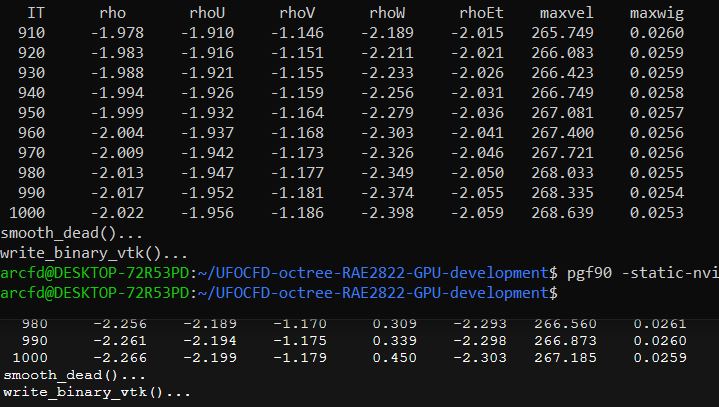

but the ‘weird’ thing, is that the convergence between CPU (top) and GPU (bottom) is not that different, except for the rhoW (w-velocity) which is the one not converging, at all on GPU. So whatever the cause of the problem is, it only appears to be affecting that array (w)
