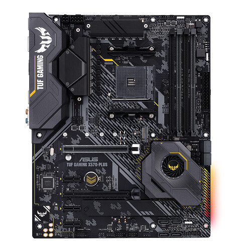

CPU : AMD Ryzen 7 3700X
Graphic card : Asus GeForce RTX 2080 SUPER Dual OC EVO
Motherboard : ASUS TUF Gaming X570-Plus
OS : Arch Linux 5.3.10-arch1-1
Driver version : 440.31-1 (dkms)
Any workaround ?

For those who have this Xid 61 bug: do you have your GC placed on the PCI slot at the bottom of your motherboard? Did you try to place it on the top one?

striffly, looking at the ASUS manual for their x570/B450 mainboards, running a single graphics card in any but the first slot (next to the cpu) is an unsupported configuration.
The slots are all for gpus but have to be populated in a specific order depending on number of gpus/Ryzen gen.
I have B450 MB. GC is in the top one next to the CPU.
