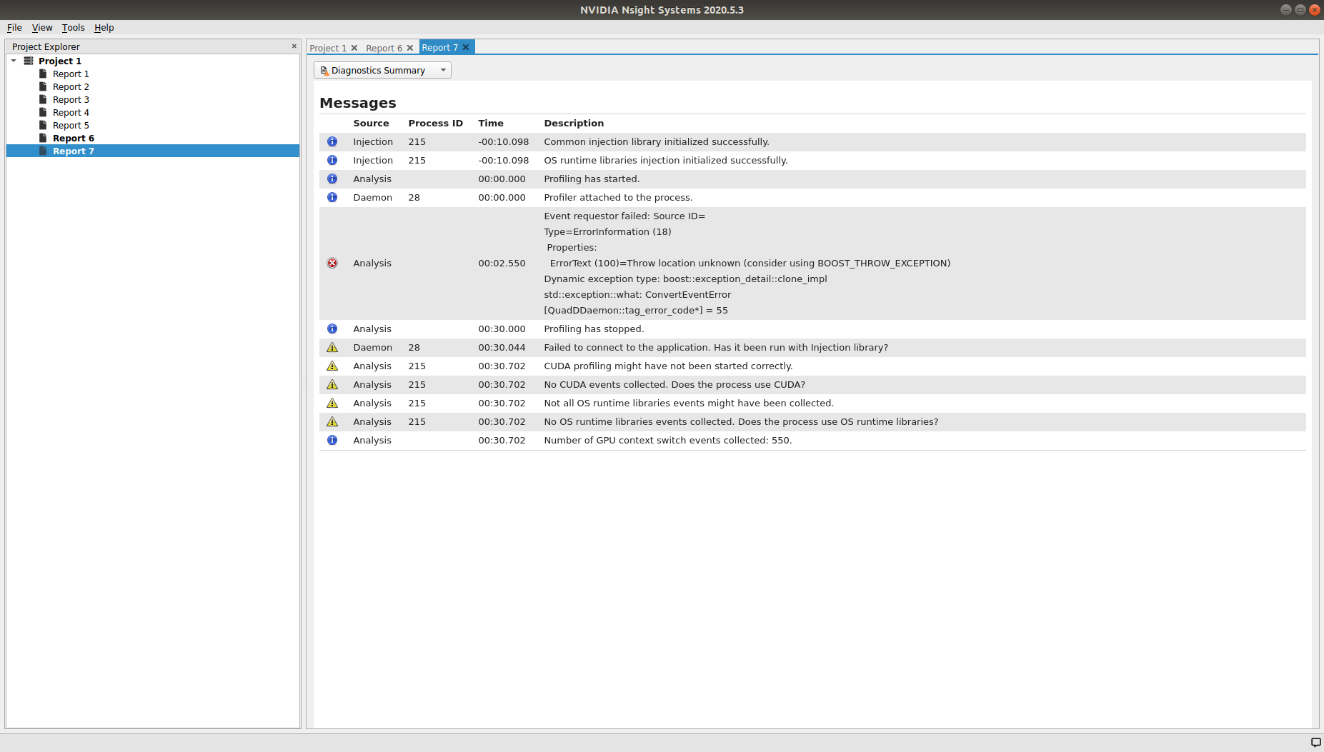

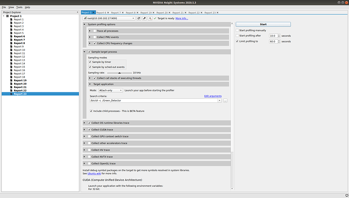

From the host computer - Ubuntu, which I used to install Jetpack (currently 4.5.1), I use Nsight Systems 2020.5.3.
It has been quite difficult to follow the documentation, has some state that one can only use Attach with remote SSH and some state that it’s possible to launch remotely. I only tried to attach, but it keeps showing errors messages such as:
Failed to connect to the application. Has it been run with Injection library?
CUDA profiling might have not been started correctly.
No CUDA events collected. Does the process use CUDA?
In some cases I see the following error as well, but not always:
Event requestor failed: Source ID=
Type=ErrorInformation (18)
 Properties:
  ErrorText (100)=Throw location unknown (consider using BOOST_THROW_EXCEPTION)
Dynamic exception type: boost::exception_detail::clone_impl
std::exception::what: ConvertEventError
[QuadDDaemon::tag_error_code*] = 55
Using LD_PRELOAD=/opt/nvidia/nsight_systems/libToolsInjectionProxy64.so at start doesn’t make much sense as it produces an error:
ERROR: ld.so: object ‘/opt/nvidia/nsight_systems/libToolsInjectionProxy64.so’ from LD_PRELOAD cannot be preloaded (cannot open shared object file): ignored.
This happens because /opt/nvidia/nsight_systems is being created by the host nsight systems.
I did check Include child processes, which seems to be required in my case.

L4T r32.6.1 corresponds to JetPack 4.6, which shipped with Nsight Systems 2021.2.3. My suggestion is to use that version instead of 2020.5.3.
The Dockerfile installs nsight-systems-cli, but those builds are intended for Arm SBSA servers, and do not support Tegra. Only Nsight Systems distributed through JetPack supports profiling on Tegra.
The Attach mode has been deprecated in recent versions on Nsight Systems. Unfortunately, we might not be able to assist you further, if you experience problems with it.
My suggestions are:
  • Use Nsight Systems 2021.2.3 from JetPack 4.6 (and stay tuned for future JetPack releases, they often ship with a new version of Nsight Systems)
  • Use Nsight System CLI - /opt/nvidia/nsight_systems/nsys - to profile your application. This is a more agile approach, especially in more complex scenarios, compared to profiling from the GUI. To get the binaries installed on the target (Jetson), connect to it once from the host GUI. Also JetPack 4.6 ships with an Arm64 CLI .deb package that is installed directly on Jetson. In this case, the CLI can be used straight from /usr/local/bin/nsys.
If the problem reproduces with a more recent version, we can then discuss how to troubleshoot it further.
