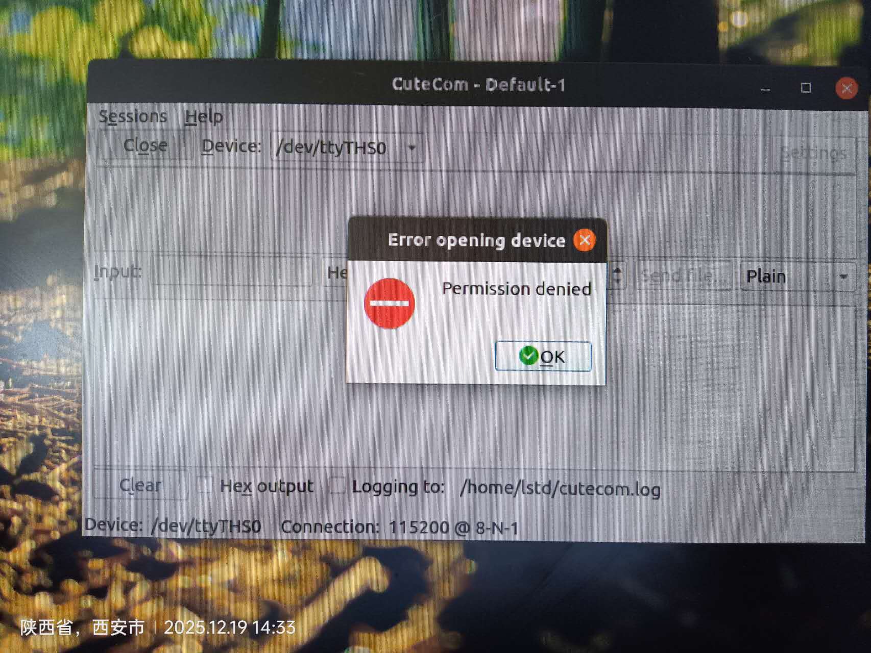

I use Cutecom to debug serial port UART1. After I connect the hardware and click the “OPEN” button, the following window will appear.
May I ask why the refusal was made? Is there anything that needs to be set?
Did you run in root user mode?
Done, thank you very much for your guidance.

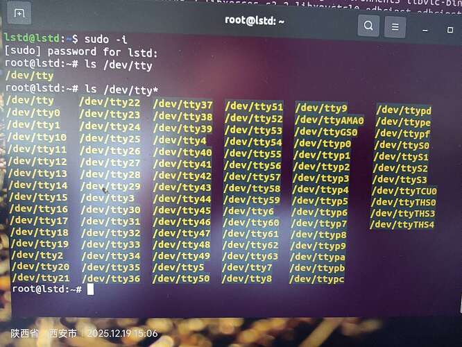

execute the below command first and check if the uart access port is listed
$ls /dev/tty*
If it is not listed then you may need to install the driver and make sure the ttyTHS0 gets listed first under /dev
Orin Nano board has 3 Uarts, but here only TTYTHS0, why are there no TTYTHS1, TTYTHS2? If I use UART1, how do I choose TTYTHS?
