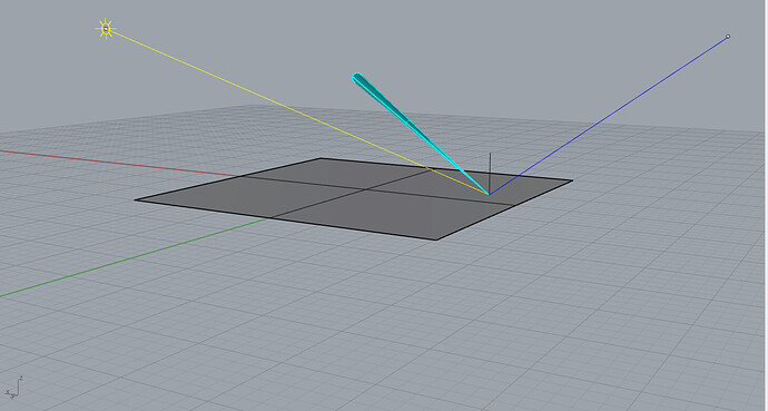

I implemented a code as far as i understand from what you suggest. The scenario is as below. where black line is surface normal, blue is incident ray, cyan is specular reflected ray (with 0.53 cone angle) and yellow is light direction.
Code is simple. If the light direction is inside the cone, that is acos of the dot product of the light direction and the reflected ray is less than 0.53, then add the weighted light emission. Else i set the diffuse color.
I calculate the weight as below.
I select a random point on a sphere (Sphere Point Picking -- from Wolfram MathWorld) and then add to the light center. So, i find a random light position inside the sphere like the optix example does for parallelogram light position. If it is wrong or there is a better way, please tell me. Also, I am not sure about my assumption of LnDl is 1.0. I assumed so because i thought i did not need to rotate the sun towards the surface. In other words, i thought it was no matter how much a sphere was rotated. If wrong, what should the light normal be in order to calculate LnDl?
The result of this implementation is below.
The shape strictly depends on how the light position is selected. Also, even though there is an elliptical brightness in the center, whole shape still looks circular. As changing the observer (camera) location, i get different combinations of sun-surface-observer positions. But still, the shape on the surface is circular.
Could you suggest any solution or refer me to a reference which mention how to handle this?
What light transport are you implementing?
Let’s name your vectors.
N == surface shading normal (black)
L == normalized direction vector to light, sun (yellow)
I == continuation ray of your BRDF sampling (cyan)
O == direction vector from surface to observer, negative ray direction (blue)
Two cases:
1.) Explicit lighting.
That’s when your continuation ray hits the sun. That condition can be checked very easily.
The dot product of two normalized vectors is the cosine between these two vectors.
If that value is 1.0, the angle between them is zero, if it’s 0.0 the angle is 90 degrees, if it’s -1.0 the angle is 180 degrees.
Means if dot(L, I) == 1.0 then L == I and you hit the center of the sun with your continuation ray.
(Note that mathematically, the probability to randomly hit an infinitely small point or a fixed 3D vector exactly, is zero (if the floating point precision wouldn’t be limited). These are singular lights (point and directional lights), which do not exist in the physical world and can only be handled with direct lighting.)
If the sun has an angular diameter of 0.53 degrees when viewed from earth, you just need to check if the continuation ray is inside the cone with that angular diameter.
Now to open that dot(L, I) condition to a cone you need to compare its result to a threshold slightly smaller than 1.0, means a bigger opening angle than 0.0.
That threshold value is 1.0 minus the cosine of the half of the sun’s angular diameter, means
threshold = 1.0f - cosf(degrees_to_radians(0.53f * 0.5f)); // == 1 - cos(radius).
That’s a constant which can be calculated up front.
The full check if the continuation ray hit the sun would be this:
prd.radiance = make_float3(0.0f);
// Sample surface and get continuation ray "I".
// For a pure diffuse distribution (Lambert), this is a cosine weighted hemisphere.
// Explicit light hit?
if (threshold < dot(I, L))
  prd.radiance += sun_emission;
  return; // End of path when hitting the sun.
When not implementing direct lighting this will eventually converge against the correct result when shooting enough rays. This would be a brute force path tracer with no direct lighting. Because the sun’s solid angle is very small, this will need an enormous amount of rays though.
This would be your reference against which you would need to compare any additional light calculations.
You could make the sun radius bigger for tests to see that this works correctly.
Else I set the diffuse color.
That would imply the material is pure diffuse (Lambert) and there is another white environment light around your scene with no occluders. Don’t do that when debugging the sun’s contribution alone.
Not sure what that is, but the normal comes into play during the continuation ray sampling and when contributing direct lighting.
There is a cosine factor describing the falloff of light contributions depending on the incident angle of the incoming light direction inside the rendering equation.
https://www.pbr-book.org/3ed-2018/Light_Transport_I_Surface_Reflection/The_Light_Transport_Equation
