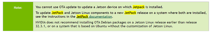

To test it with JetPack 4.6.1, I have to uninstall the current JetPack version and reinstall the new one or can I just upgrade it in a simple way ?
YES. You can upgrade it with our OTA command:
https://docs.nvidia.com/jetson/archives/l4t-archived/l4t-3261/index.html#page/Tegra%20Linux%20Driver%20Package%20Development%20Guide/updating_jetson_and_host.html#
In the link you gave me it says that
So I can’t use OTA to upgrade the JetPack version ? I’m not sure I understood.

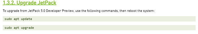

Shouldn’t I do this instead ?
This is from the link of the JetPack documentation How to Install JetPack :: NVIDIA JetPack Documentation
So I managed to update the JetPack version with the link you sent me but I still get the same issue (with TensorRT 8.2 now).
