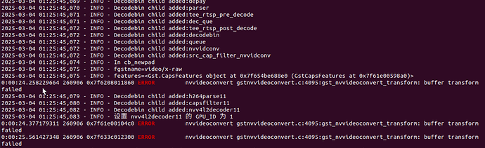

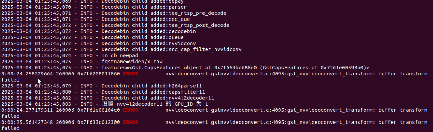

I have 3 graphics cards and I get an error when I specify a card with gpu-id=1:
0:00:22.544105378 257726 0x7fd778028760 WARN nvinfer gstnvinfer.cpp:1504:gst_nvinfer_process_full_frame:<primary-inference> error: Memory Compatibility Error:Input surface gpu-id doesnt match with configured gpu-id for element, please allocate input using unified memory, or use same gpu-ids OR, if same gpu-ids are used ensure appropriate Cuda memories are used
0:00:22.544159307 257726 0x7fd778028760 WARN nvinfer gstnvinfer.cpp:1504:gst_nvinfer_process_full_frame:<primary-inference> error: surface-gpu-id=0,primary-inference-gpu-id=1
2025-03-03 07:29:56,425 - ERROR - Error from primary-inference: gst-resource-error-quark: Memory Compatibility Error:Input surface gpu-id doesnt match with configured gpu-id for element, please allocate input using unified memory, or use same gpu-ids OR, if same gpu-ids are used ensure appropriate Cuda memories are used (1)
2025-03-03 07:29:56,425 - ERROR - Debugging info: gstnvinfer.cpp(1504): gst_nvinfer_process_full_frame (): /GstPipeline:pipeline0/GstNvInfer:primary-inference:

Here’s my code:

self.capsfilter.link(self.queue4)
if self.nvdslogger:
self.queue4.link(self.nvdslogger)
self.nvdslogger.link(self.tiler)
else:
self.queue4.link(self.tiler)
self.tiler.link(self.queue5)
self.queue5.link(self.nvvidconv)
self.nvvidconv.link(self.queue6)
self.queue6.link(self.nvosd)
if self.transform:
self.nvosd.link(self.queue7)
self.queue7.link(self.transform)
self.transform.link(self.sink)
else:
if int(MyConfigReader.cfg_dict["nvr"]["show"]):
# self.queue5.link(self.converter)
# self.converter.link(self.capsfilter)
# self.capsfilter.link(self.sink)
self.queue7.link(self.sink)
else:
return True
def create_source_bin(self, index, uri):
MyLogger.info("Creating source bin")
if not self.check_uri_valid(uri):
MyLogger.error(f"URI is invalid or unreachable: {uri}", )
return None # Ö±½Ó·µ»Ø None ±íʾ´´½¨Ê§°Ü
# Create a source GstBin to abstract this bin's content from the rest of the
# pipeline
bin_name = "source-bin-%02d" % index
MyLogger.info(bin_name)
nbin = Gst.Bin.new(bin_name)
if not nbin:
MyLogger.error(" Unable to create source bin")
if file_loop:
# use nvurisrcbin to enable file-loop
uri_decode_bin = Gst.ElementFactory.make("nvurisrcbin", "uri-decode-bin")
uri_decode_bin.set_property("file-loop", 1)
MyLogger.info("nvurisrcbin")
else:
uri_decode_bin = Gst.ElementFactory.make("uridecodebin", "uri-decode-bin")
MyLogger.info("uridecodebin")
if not uri_decode_bin:
sys.stderr.write(" Unable to create uri decode bin \n")
# We set the input uri to the source element
uri_decode_bin.set_property("uri", uri)
# Connect to the "pad-added" signal of the decodebin which generates a
# callback once a new pad for raw data has beed created by the decodebin
# todo
uri_decode_bin.connect("pad-added", self.cb_newpad, nbin)
self.source_bins[index] = nbin
uri_decode_bin.connect("child-added", self.decodebin_child_added, nbin)
Gst.Bin.add(nbin, uri_decode_bin)
bin_pad = nbin.add_pad(Gst.GhostPad.new_no_target("src", Gst.PadDirection.SRC))
if not bin_pad:
sys.stderr.write(" Failed to add ghost pad in source bin \n")
return None
return nbin
