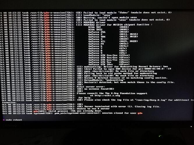

I have reproduced this issue on an Arch Linux system.
Hardware:
Gigabyte Aorus Elite z390
Intel i5 9400
Gigabyte GT 1030
Software:
linux 5.3.7-arch1-1
nvidia 435.21-13
I did a reboot from virtual terminal and took a picture of the error message that shows up after systemctl hangs on stop jobs for my display manager: http://xaptronic.com/error.html (please let me know if there is a better method to share this, I didn’t see anywhere to attach a file here)
I then “downgraded” to linux-lts ( 4.19.80-1 ) from the Arch repos and so far have not experienced the issue.

I see same.
And as you can read messages at photo: “acpi_device_remove …”
Problem can be in motherboard.
Try write to Gigabyte Support, and attache this thread.
May be thay reply you. Support in my country say me “we only support windows” thats all.

Is the information from my screen shot [1] useful at all? I’ll add this to the bug report. I will try to make some time to do bisection as well. I would if you could get a compile to work using nvidia-lts… the package manager says this is version 435.21-6 and the lts kernel is 4.19…
[1] http://xaptronic.com/error.html
