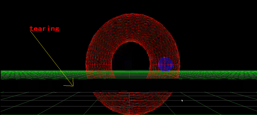

On Tegra TX1, we are using gstreamer-1.0 ximagesrc to capture the screen to a video file when an OpenGl application is rendering to display.
The run-time display is normal. However, when we play back the recorded stream, the captured video shows tearing effect when OpenGL application is in Full Screen mode, although the tearing is not seen when OpenGL app exit to window mode.
Is there any way to fix this?

gst-launch-1.0 -v ximagesrc use-damage=0 ! nvvidconv ! ‘video/x-raw(memory:NVMM),alignment=(string)au,format=(string)I420,framerate=(fraction)25/1,pixel-aspect-ratio=(fraction)1/1’ ! omxh264enc ! ‘video/x-h264,stream-format=(string)byte-stream’ ! filesink location=“test.h264” -e

Please try to download the below OpenGL app (SphereW) and run it on Tegra Tx1, then use the " gst-launch-1.0 " mentioned before to store screen capture.

Hi, Danelll,
Are you seeing the below tearing in SphereW ?

We are now still checking it. For now it looks to be an issue in ximagesrc fetching frames.
Could you try to run jetson_clocks.sh to max out all clocks?
And ximagesrc is not developed/owned by NVIDIA. Please other users could kindly share information about it.
I tried. With or without jetson_clocks.sh, the tearing is still seen.
hi HooverLv,
We don’t observe the tearing in all max clocks.
Please check tegrastats. Not sure but probably the GPU gets 100% loaded.

with jetson_clocks.sh, the SphereW is OK.
But out use case where 7 PAL video are captured and streamed to GPU the issue is still there.In our real case GPU is 100% loaded, however when exit from full sreen to windows mode, the GPU usage did not change, but recorded data is fine, So I guess GPU usage is not root cause?
