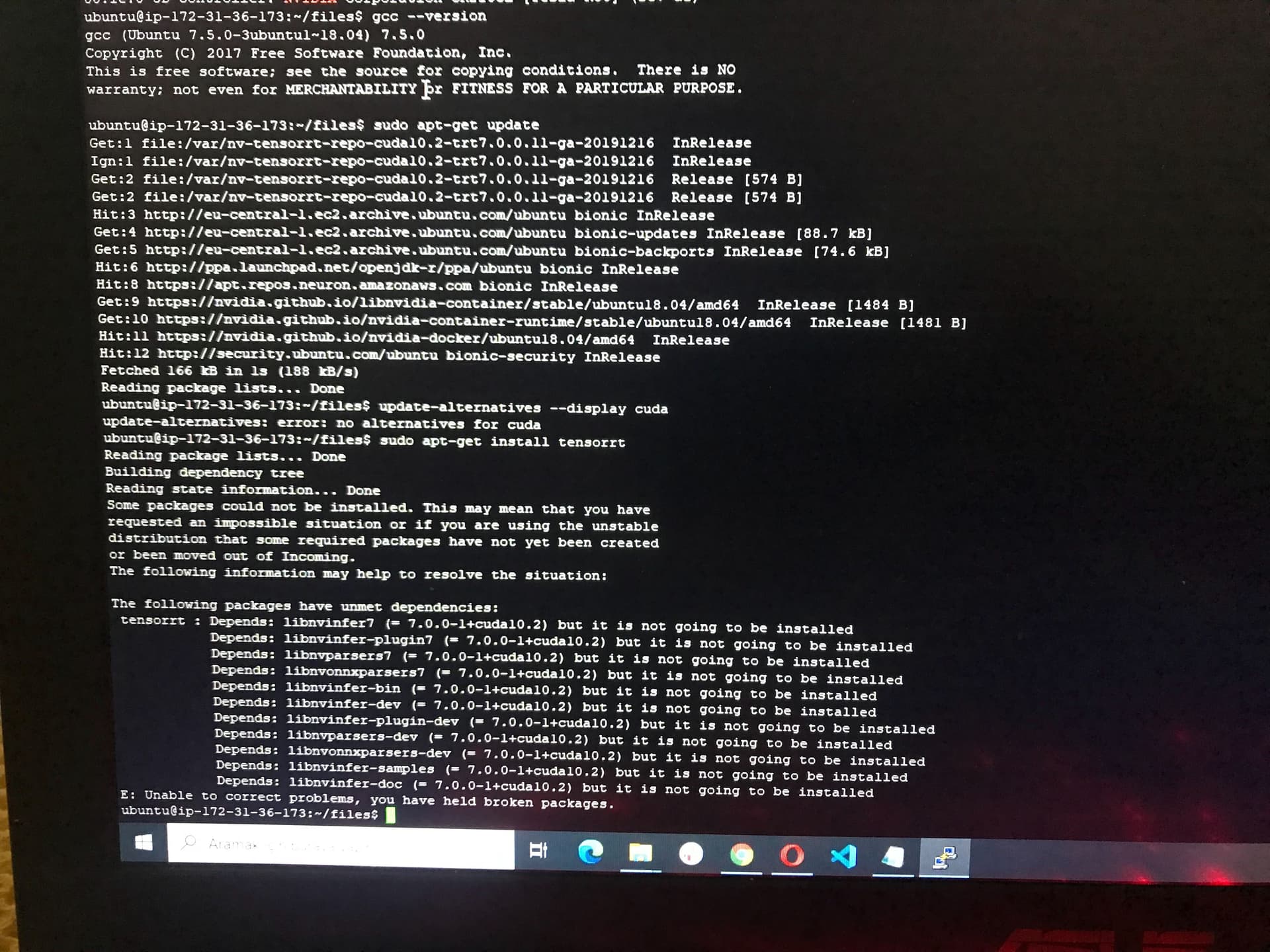

I am trying to install TensorRT on ec2 Deep Learning AMI (Ubuntu 18.04) Version 48.0.
Since CUDA and cuDNN are installed, I only download the TensorRT installation file which is ‘nv-tensorrt-repo-ubuntu1804-cuda10.2-trt7.0.0.11-ga-20191216_1-1_amd64.deb’.
But, when I run the installation file, I got following error.
I tried the install these libraries (libnvinfer7) but couldnt manage it.
What should I do?
Or could someone suggest me a better way to install TensorRT to ec2 ubuntu system?

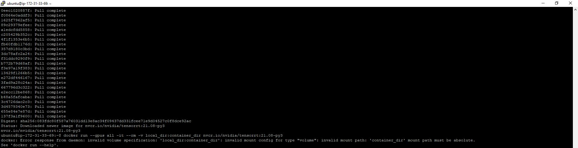

I started a new Deep Learning AMI (Ubuntu 18.04) Version 48.0 instance and try to use TRT NGC but I got an error.
Firstly, I installed the ngc and match my API key. Then, I pull the TensorRT container (docker pull nvcr.io/nvidia/tensorrt:21.08-py3).
After that, I try to run this container by nvidia-docker run -it --rm -v local_dir:nvcr.io/nvidia/tensorrt:21.08-py3 command, I got an error like this.
Why I am getting this error?
What should I do different or what did I do wrong way?
Looks like you mentioned volume path wrong as local_dir:container_dir. Please mention local dir path as local path on your aws machine. Also please give container directory in correct format, ex: /home/data/
Thank you.
Please refer to the installation steps from the below link if in case you are missing on anything
I followed the instructions in that doc and arrived at the same error that skilic shows in the first post: a bunch of lines saying that tensorrt depends on various libnv* libraries but that those won’t be installed. There is no reason given for why. Is there a separate package that needs to be installed before tensorrt that is not mentioned in the instructions?
EDIT: I figured out the issue on my end, the instruction say to make sure you have a valid version of CUDA, which I had (driver CUDA 11.0) but for some reason the toolkit version didn’t match the driver version (nvcc --version returned 10.0). Updating the toolkit to 11.0 and then redoing the steps succeeded.
