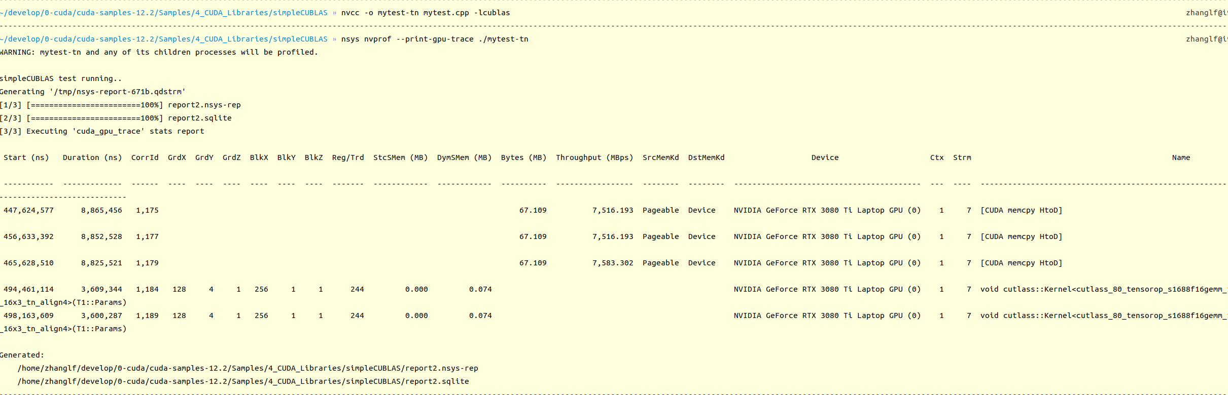

The best input layout settings in CuBlas
I understand that the memory layout of input matrices affects the performance of cuBLAS GEMM. According to the information I’ve found ( cuBLAS related question - CUDA / CUDA Programming and Performance - NVIDIA Developer Forums), the NT case (that is, for A*B, A is row-major and B is column-major) should be the fastest. However, I observed different phenomena on my RTX 3080 Ti 3080 laptop. I ran the simpleCublas example from the CUDA Toolkit samples and set cublasSetMathMode(handle, CUBLAS_TENSOR_OP_MATH);. Then I added some precise timing code. I tested several sizes, such as m=n=k=1024, 1048, 4096. I found that the TN case was always slightly better than the NT case. So, has NVIDIA now done some special optimization for the TN case ? Or could someone verify this phenomenon? thanks.
the test results :
m=n=k=4096
TN: 3951 us
NT: 4247 us
m=n=k=2048
TN: 704 us
NT: 780 us
m=n=k=1024:
TN: 205 us
NT: 220 us
my codes :

Using approximately your code, on my L4 GPU, on linux with CUDA 12.2, I found the NT case to be a bit faster. It’s entirely possible for cublas to behave slightly differently on different GPU architectures, or different GPUs. It may also vary by CUDA version, so if you are using CUDA 11.4, that may be another factor.

# nvcc -o t264 t264.cu -lcublas
# nsys nvprof --print-gpu-trace ./t264
WARNING: t264 and any of its children processes will be profiled.
simpleCUBLAS test running..
Generating '/tmp/nsys-report-e836.qdstrm'
[1/3] [========================100%] report10.nsys-rep
[2/3] [========================100%] report10.sqlite
[3/3] Executing 'cuda_gpu_trace' stats report
 Start (ns)   Duration (ns)  CorrId  GrdX  GrdY  GrdZ  BlkX  BlkY  BlkZ  Reg/Trd  StcSMem (MB)  DymSMem (MB)  Bytes (MB)  Throughput (MBps)  SrcMemKd  DstMemKd     Device      Ctx  Strm                                            Name
 871,260,644     17,751,373   1,174                                                                               67.109          3,758.096  Pageable  Device    NVIDIA L4 (0)    1     7  [CUDA memcpy HtoD]
 889,183,249     16,269,804   1,176                                                                               67.109          4,093.641  Pageable  Device    NVIDIA L4 (0)    1     7  [CUDA memcpy HtoD]
 905,625,789     16,187,244   1,178                                                                               67.109          4,093.641  Pageable  Device    NVIDIA L4 (0)    1     7  [CUDA memcpy HtoD]
 954,185,121      2,372,930   1,183   256     2     1   256     1     1      244         0.000         0.074                                                     NVIDIA L4 (0)    1     7  void cutlass::Kernel<cutlass_80_tensorop_s1688f16gemm_256x128_16x3_tn_align4>(T1::Params)
 956,592,099      2,397,250   1,188   256     2     1   256     1     1      244         0.000         0.074                                                     NVIDIA L4 (0)    1     7  void cutlass::Kernel<cutlass_80_tensorop_s1688f16gemm_256x128_16x3_tn_align4>(T1::Params)
Generated:
    /root/bobc/report10.nsys-rep
    /root/bobc/report10.sqlite
# nvcc -o t264 t264.cu -lcublas -DUSE_NT
Generating '/tmp/nsys-report-276b.qdstrm'
[1/3] [========================100%] report11.nsys-rep
[2/3] [========================100%] report11.sqlite
   925,761,720     17,598,285   1,174                                                                               67.109          3,758.096  Pageable  Device    NVIDIA L4 (0)    1     7  [CUDA memcpy HtoD]
   943,531,109     16,568,365   1,176                                                                               67.109          4,026.532  Pageable  Device    NVIDIA L4 (0)    1     7  [CUDA memcpy HtoD]
   960,278,034     16,061,292   1,178                                                                               67.109          4,160.750  Pageable  Device    NVIDIA L4 (0)    1     7  [CUDA memcpy HtoD]
 1,009,513,943      2,154,626   1,183   128     4     1   256     1     1      239         0.000         0.074                                                     NVIDIA L4 (0)    1     7  void cutlass::Kernel<cutlass_80_tensorop_s1688f16gemm_128x256_16x3_nt_align4>(T1::Params)
 1,011,702,137      2,184,514   1,188   128     4     1   256     1     1      239         0.000         0.074                                                     NVIDIA L4 (0)    1     7  void cutlass::Kernel<cutlass_80_tensorop_s1688f16gemm_128x256_16x3_nt_align4>(T1::Params)
Generated:
    /root/bobc/report11.nsys-rep
    /root/bobc/report11.sqlite
CUBLAS SGEMM has a special behavior when you set the TENSOR_OP_MATH setting. As far as I know that setting is deprecated and CUBLAS SGEMM may someday no longer have that path to use Tensor Core. You will have to use an alternate CUBLAS API to use tensorcore. And if you are interested in information in/comparison with advice given in a 11 year-old thread, it probably doesn’t make sense to do a comparison with tensorcore, anyway.

  1. As you said, the OS might also affect the results. So I conducted experiments on Ubuntu 22.04 with CUDA 12.2, using exactly the same code and commands as you did. The nvprof results were still consistent with what I observed on Windows: TN-case slightly outperforms NT-case.
my results for NT and TN cases on Linux with CUDA 12.2 using nvprof and nsight-compute-gui :
NT-case-cuda-12-2-linux-nvprof:
TN-case-cuda-12-2-linux-nvprof:
NT-case-cuda-12-2-linux-nsc-gui:
TN-case-cuda-12-2-linux-nsc-gui:

The tool I used is nsys, not nvprof. nsys happens to have a command line argument option that is called nvprof, but it does not use the nvprof tool. Anyway, ncu is a suitable alternative.
I don’t doubt that in various situations TN may give better performance than NT. The reason for my posting was to indicate that I don’t think you can draw that conclusion universally.
For questions pertaining to the internal workings of CUBLAS, I won’t be able to answer those: it is a closed-source library.
Considering the test case you posted for CUDA 12.2 on linux, the difference in performance from NT to TN appears to be about 4%. Given that you have a test case where TN appears to be faster than NT by about 4%, and I have a similar test case where NT appears to be faster than TN by about 10%, I would hesitate to draw directional conclusions or guidance from that. Neither one is dramatically faster than the other.
