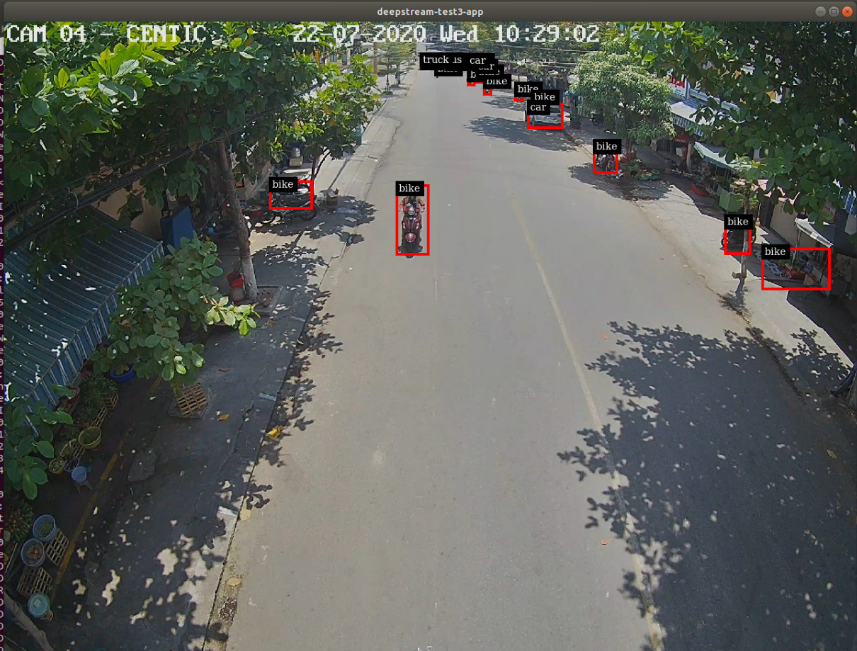

I’m using Nvidia TLT to train my own YoloV3 model and can succesfully get good result with FP16 mode, but when export Int8 mode by tlt-export, and use .etlt and cal.bin file to Deepstream, it can not detect anything. I attach my cal.bin file, Deepstream config, image detect by fp16 and int8 mode. I aslo try to generate Int8 engine by tlt-converter but no luck.

Please set to
cluster-mode=3
and retry.
I tried, but still nothing detected.
Suggest to using tlt-infer inside the docker to verify int8 engine firstly.
To check if its output is good.
You can refer to the commands inside jupyter notebook.

Hi, it the same, nothing detected, here is command used for tlt-export

Please double check if tlt-infer can have a good output (check the output in $USER_EXPERIMENT_DIR/yolo_infer_images).
Above is just tlt-export log.
More, if you still find tlt-infer has not a good output, there should be something wrong in cal.bin or others. Please set "–-batches " to at least 10% of your training dataset and generate cal.bin again.
