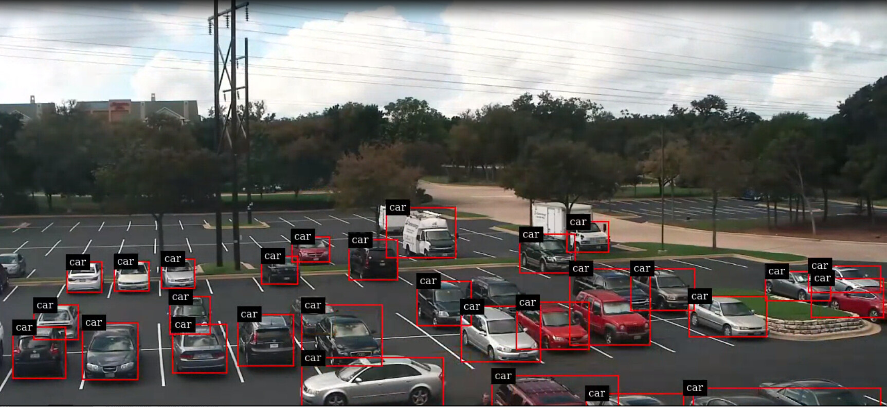

Sharing some results, this is the original TrafficCamNet performance for reference:

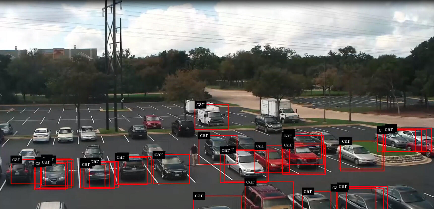

Now the TLT training results. As you can see even with the frozen layers it quickly loses the ability to detect most of the cars.
(Please don’t mind about the multiple bounding boxes for the same object, I’ve reduced the thresholds and clustering settings to be able to visualize everything)

More, your current training result shows that the mAP can reach 96.8% during evaluation but its inference result is not good. Can you double check? And what is your inference spec?
Training 120 epochs without frozen blocks was my initial attempt, but the resulting model ended overfitted to the “parking lot” perspective. When using it in other scenarios like dash-cam view TLT model gets a lot of false positives and lack of detection.
Sorry, I forgot to mention the images that I shared on the previous post does not belong to the training/testing dataset used on TLT.
They are printscreens for comparison purpose of the inference results on DeepStream when running the original model and the TLT model, but using a completely different input video. Hence there’s no direct relation with the mAP values from the training evaluation, they are there just for reference.
(well, I guess due to overfitting the relation might be: slightly_different_input_video_mAP = 1-training_mAP :) )

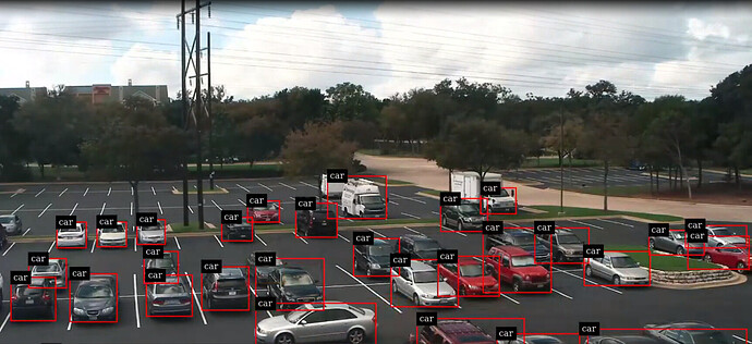

As you can see for 120 epochs without frozen blocks, results are not that different:
Validation cost: 0.001908
Mean average_precision (in %): 97.9555
class name      average precision (in %)
car                              97.9555
Basically I would like to improve the results of the 1st image I shared, but they just got worst with training.
