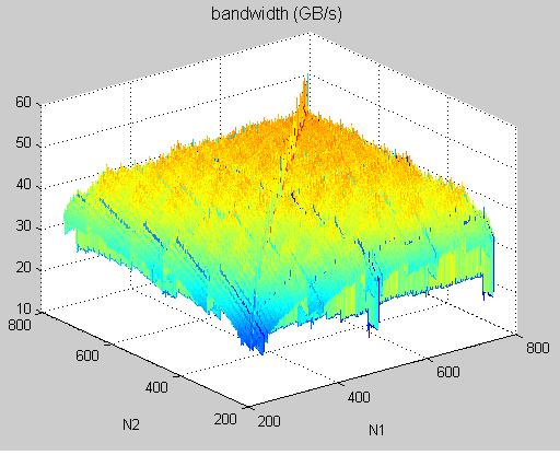

experiment 2: sweep n1 != n2 and I want to show asymmetry of performance observed by Jimmy Pettersson.
In figure 3, we plot bandwdith over (n1,n2), n1, n2 = 200:800. one can see some low bandwidth sample near
n1 = 500 or 800
figure 3

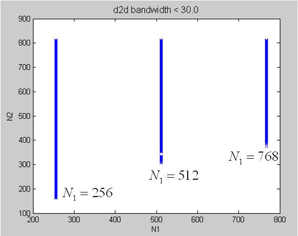

if we extract dimension (n1,n2) which has bandwidth less than 30GB/s, then result is shown in figure 4
figure 4
clearly, from figure 4 speedup is asymmetric.

I have an explanation of asymmetric of bandwidth result.
look at figure 4
the experiment acts on a 2-D data set with dimension N1 x N2, say A(1:N1, 1:N2)
[codebox]
 <--- N2 --->                                      <--- N1 --->
| | A | , transpose to B(1:N2, 1:N1) | | B |
N1 | | N2 | |
v ±---------+ v ±---------+
[/codebox]
values of N1 and N2 do not affect coalesced property of “read operation” in coalesced method,
active warps are divided evenly among partitions. However value of N1 is important for “write operation”,
when N1 is multiple of 256 “double” ( 2048 bytes, i.e. 8 partitions of 256-byte width), then active blocks
in Cartesian coordinate would fall into the same partition, then throughput decreases.
This shows asymmetry of bandwidth over (N1, N2) since only value of N1 can affect “partition camping”.
( partition camping is used to describe the case when global memory accesses are directed
through a subset of partitions, causing requests to queue up at some partitions
while other partitions go unused )
From figure 4, N1 = 256, 512, 768 have poor bandwidth, this proves above explanation.

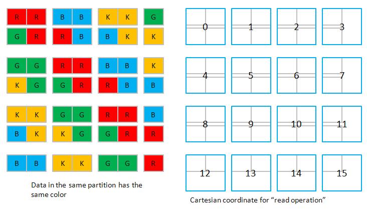

Question: why does performance degradation of “diagonal ordering” occur at N+1 = multiple of 256?
Ans: We use Tesla C1060 which has 8 partitions of 256-byte width (or say 32 doubles width),
so all data in strides of 8 x 32 = 256 doubles map into the same partition.
In order to simplify discussion, let us assume 4 partitions of 2-double width,
then all data in strides of 4 x 2 = 8 doubles map into the same partition.
Here we choose N = N1 = N2 = 7 and TILE_DIM = 2.
we use 4 colors to represent 4 partitions, first partition is red, second is blue, third is orange and fourth is green.
data set A(1:7, 1:7) can be arranged as square matrix and we color each data element to show its partition,
the whole matrix is shown in left panel of figure 9.
right panel of figure 9 is placement of blocks in Cartesian coordinate when do “read operation”, note that
each block has dimension 2x2 since TILE_DIM=2 is assumed.
figure 9
block 0~3 access 4 partitions and achieve high bandwidth,
similarly, block 4~7, block 8~11, and block 12~15 all access 4 partitions.
The same thing holds in Cartesian coordinate whne do “wrtie operation”, see figure 10.
block 0~3, block 4~7, block 8~11, and block 12~15 all access 4 partitions.
figure 10

finally I want to show symmetric property of diagonal-ordering.
sweep n1 != n2, and show bandwidth in figure 13. Roughly speaking, the graph is symmetric.
if we extract dimension pari (N1,N2) which has bandwidth less than 30GB/s, and show result
in fugre 14, then it is symmetric if one focus on N1 > 500 and N2 > 500
figure 13
figure 14
Question: why does diagonal-ordering keep symmetric property whereas coalesced method does not?
Ans: Suppose A has dimension 511 x 60, then “write operation” has slow performance due to
partition camping when do diagonal-ordering. How about transpose of A, with dimension 60 x 511?
now transpose of A has slow performance in “read operation” due to partition camping when do
diagonal-ordering.

in figure 1, we compare “diagonal-ordering” with “Coalesced method” on 3-D transpose problem on Tesla C1060, then
“Coalesced method” is weak on N = 256 + multiple of 128
“diagonal-ordering” is weak on (N+1) = multiple of 256 and (N-128+1) = multiple of 256.
however for N = 512, “diagonal-ordering” is not good enough though we expect that
“diagonal-ordering” has best performance when N = multiple of 256.
figure 1

I also noticed this problem when doing experiments on “data copy” and “data transpose”,
figure 2 shows result of 3-D data copy, “float” and “double” on Tesla C1060
figure 3 shows result of 3-D transpose, “float” and “double” on Tesla C1060
figure 2
figure 3

Next we label each tile with one color to show its partition, in figure 3, a tile of type “double” occupies a partition, under Cartesian coordinate ordering, all 8 partitions are activated simultaneously. This is the best way that we can expect.
figure 3:

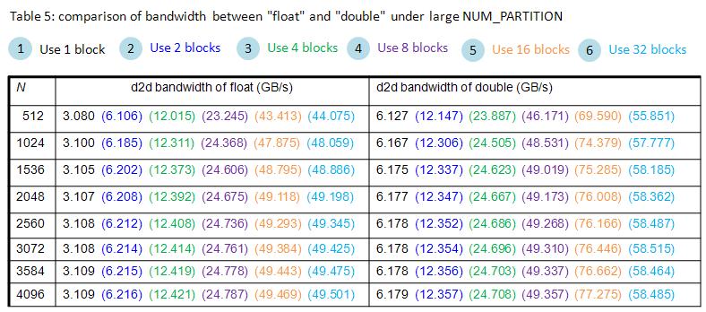

in figure 4, two tiles of type “float” occupy a partition, if number of active blocks exceeds 16, then we also expect that all partitions can be active
at the same time. Under consideration of partition camping, we cannot distinguish performance between “float” and “double”.
figure 4:
in figure 5, we use 32-float as basic color rectangle since one row of a tile is 32-float3 which is 32x3x4 = 378 byte, this exceeds width of a partition (256 bytes).
two tiles of type “float3” occupy two partitions, this increase degree of difficulty to analyze its effect of partition camping.
some partitions across two blocks,
figure 5:
The result of experiment on TeslaC1060 is show in table 1. It is clear that bandwidth of “float” is slightly smaller than bandwidth of “double”,

PART III: boundary of a tile is aligned to boundary of a partition
From previous discussion, configuration of coalesced method is good for “double”, but not good for “float” and “float3”.
Rule of thumb: choose a thread block to deal with a tile with boundary aligned to a partition (width of a tile is equal to width of a partition).
Next we demo a another example, called “blockEqPartition”, in which
  1. it uses tile = 32 x 16 to deal with type = “double”
  2. it uses tile = 64 x 8 to deal with type = “float”
Here we neglect type = “float3” since it is hard to match “width of a tile is equal to width of a partition”

We use parameter “NUM_PARTITION” to set how many SMs are used in the kernel.
In upper panel of figure 9, a tile has dimension 32 x 16 (type is “double”), there are 8 x 16 = 128 tiles in 256x256 data, however only one thread block (32x16 threads) is invoked to deal with 128 tiles for NUM_PARTITION = 1. This means that only one SM works, remaining 29 SMs are idle.
here we adopt Cartesian coordinate ordering such that consecutive 8 blocks can activate 8 partitions simultaneously.
if NUM_PARTITION = 2, then two thread blocks are invoked to handle 128 tiles (say only two SMs do work ), execution order is shown in lower panel of figure 9.
figure 9:

Comparison of bandwidth between “float” and “double” under different NUM_PARTITION is listed in table 4
from experimental result, bandwidth of “double” is two times the bandwidth of “float”.

Remark: from experiment data, bandwidth (1 block, float) is 3.1 GB/s, this is smaller than 4.84GB/s.
Hence memory latency may be larger than 400 cycles.
Conclusion: 16-double is 2 times the size of 16-float such that it requires 2 cycles to pass through 512-bit memory interface.
However 16-double has benefit if burst of memory bus is regular under transfer of 16-float. In our “blockEqPartition" example,
burst of memory bus is less than duration of index computation when NUM_PARTITION is less than 8. Hence bandwidth of 16-double
is always twice than bandwidth of 16-float.
However this kind of analysis does not hold for large NUM_PARTITION = 32.
In Table 5,? when NUM_PARTITION = 32, bandwidth of float does not increase whereas bandwidth of double decreases, this is very strange,
I don’t have any idea to explain this.
