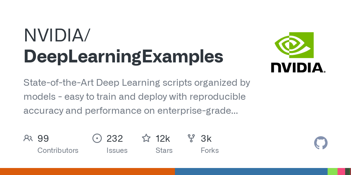

You can refer to the Triton document for the examples:

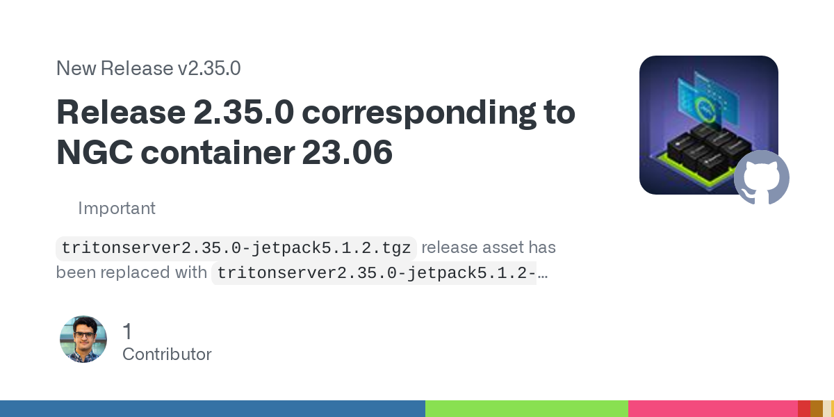

Hi @utkarsh.tiwariblr47, check the Triton releases page on GitHub for the Jetson releases:
See here for the containers:

In this page it is mentioned " For Jetson devices which support Jetpack 6.0 and above, Triton now publishes containers, based on the latest version of Jetpack, on NGC with the suffix -igpu".
So does that mean i can simply pull the container image according to the following link. Would that avoid manual installation of Triton inference server on Jetson?
Yes, please use the container with -igpu tag and it should have Triton preinstalled.
