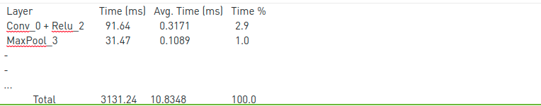

Dear Sir,
I am sharing you the layer-wise profiling of the model.
Profile (289 iterations ) ===
Model layers and structure is kept confidential.
You can find the final sum of profiling time.
I want to understand, when i have used the flag " --avgRuns=1" then why iteration in the logs is Profile (289 iterations)
this model ran with single input with single iteration and gives performance as
above.
Please let me confirm , which is the correct profiling result either 3sec or 11ms?
And I want to understand why iteration is 289 when the model is provide with the flag to restrict the inference repetition.
Regards,
Vyom Mishra

Regarding your other query on layer-wise profiling, let us get back to you.
