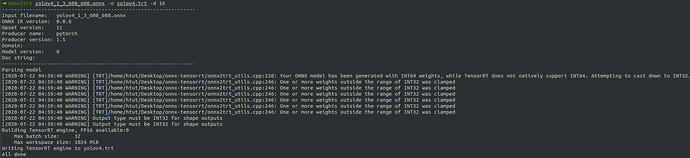

I was having the same problem when I tried to port the yolov4 onnx model to TensorRT with trtexec.
Using onnx-tensorrt solved the problem for me. At least, that sort of warning message didn’t come up anymore.

Hi, @Htut, what does the -d 16 means ?
