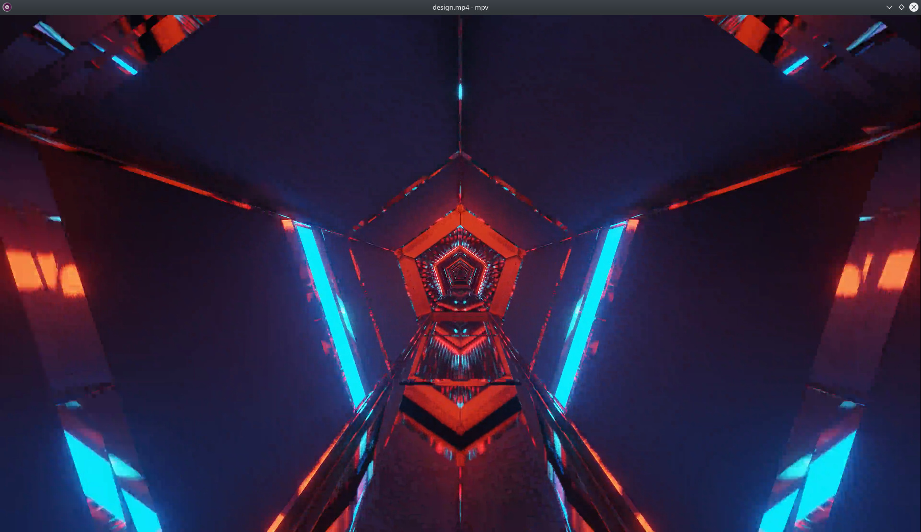

I am developing a general purpose video encoding application. Encoder used with CBR (constant bit rate) option. It’
s important.
But artifacts appear on dynamic video scenes after encoding.

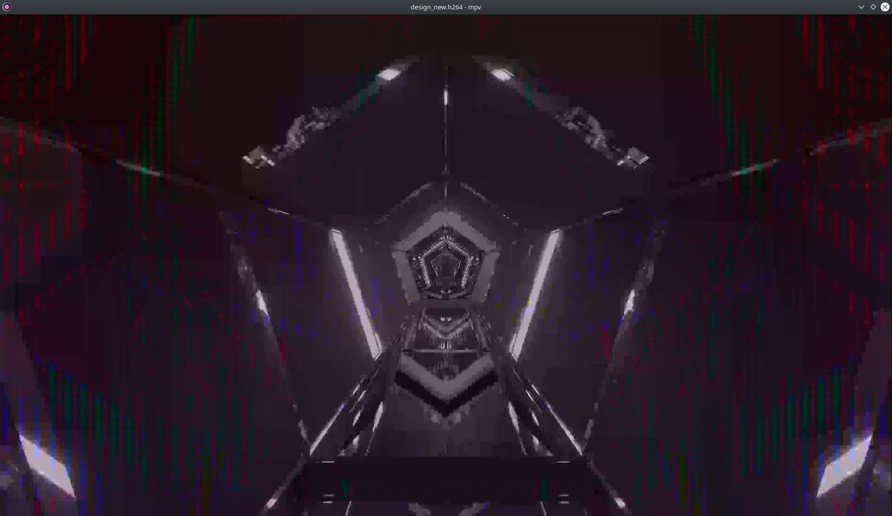

I provide screenshots of the video after encoding that I receive after running the example and the original video.
I followed these steps
# take h264 bitstream from mp4 container
ffmpeg -i design.mp4 -vcodec copy -an -bsf:v h264_mp4toannexb design.h264
# take decoded raw file
tegra_multimedia_api/samples/00_video_decode/video_decode H264 --disable-rendering -o design.raw design.h264
# encode raw file
tegra_multimedia_api/samples/01_video_encode/video_encode design.raw 3840 2160 H264 design_new.h264 -rc cbr --max-perf
What other options can you customize? What can you advise for setting up the encoder to encode such dynamic scenes.

Be default the bitrate is 4Mbps which looks too small for 4K
        -br <bitrate>         Bitrate [Default = 4000000]
Suggest you try 16Mbps.
I am attaching result with original bitrate 23000K
# encode raw file with original bitrate
tegra_multimedia_api/samples/01_video_encode/video_encode design.raw 3840 2160 H264 design_new.h264 -rc cbr --max-perf -br 23000000
Please try to configure virtual buffer size:
        -vbs <size>           Virtual buffer size [Default = 0]
Here is a reference link:
And hardware preset type:
        -hpt <type>           HW preset type (1 = ultrafast, 2 = fast, 3 = medium,  4 = slow)
Please note hardware preset type improves image quality but affects encoding speed. Slow type may not be able to achieve 4Kp30.
unfortunately i got same result (artifacts) with following options
tegra_multimedia_api/samples/01_video_encode/video_encode design.raw 3840 2160 H264 design_new.h264 -rc cbr --max-perf -br 23000000 -vbs 56000000 -hpt 3
The setting looks strange. Bitrate is 23Mbps and virtual buffer size is 56Mbps. You may try virtual buffer size = bitrate/framerate. And 23Mbps may be small for 4K. Please try 40Mbps.
Ok.
Please show a set of parameters acceptable from your point of view for encoding this example video.
The scene looks complex and I think 40Mbps may not be enough. However, there is trade-off between video quality and bitrate. In general, 40Mbps should be good for most ordinary scenes.
