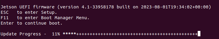

- After rebooting, confirm that CapsuleUpdate is executed using BUP
Image of Capsule Update:
Check results after reboot:
